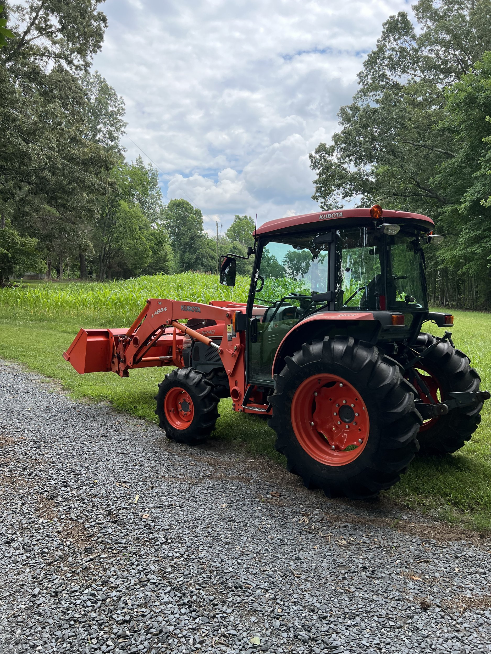

I appreciate all the information and valuable thoughts shared. I had narrowed my choice down to the 4066R or L6060. After speaking with multiple dealers in my area there was no definitive time frame on when I could expect a tractor to arrive after ordering. Many dealers were still trying to complete orders from last year. I decided to keep searching the used market within a few state radius for a little while longer while awaiting a shift in the new market supply. As luck would have it a 2011 Kubota L5240 with only 600 hours with options showed up on marketplace only 12 miles away! It now sits at my place so my search is over. Thanks again.
/ John Deere 4066r reliability #10
If you get a chance post up a pic of your “new” machine. Congrats on the find.

Nice rig!
