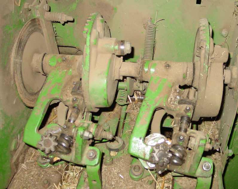

Hello everyone, we have a JD 336 and are having an issue I hope someone can help with. When going forward with tractor the baler won't tie a knot on the left side, however if the tractor is not moving and you feed the hay into the baler manually, it works just fine. Any suggestions? Thanks for your help in advance.

I used an old 336 first cutting this year for about 1250 bales. It only missed about 20 knots, but they were always on one side and always when under the load of a heavy windrow. I wondered, when I read your post, if perhaps the difference between manually throwing hay into the baler and driving the tractor is simply the rate at which the hay feeds into the machine--much heavier when driving along picking up a fat windrow, thus the bum knotter shows only then?
Which then makes me wonder if it is either some worn knotter parts on that side that can't handle the heavy work load, or else a dull knife at the edges of the plunger that puts a bind on the whole machine and makes the knotter malfunction when plunging a heavier load than when throwing in armloads of hay?

Your accordian effect is related to the stationary and plunger knife alignment. They need to be shimmed out to put them closer together. Be careful though, if they hit, your gonna have some expense. So many writers say their baler "missed a knot", but never describe the "missed knot" end conditions. Did the knot break post tie? Did it never get thru the knotter intact?
Most common missed knots are due to the tucker fingers not bringing the closing twine end back to the billhook. Because of wear, this linkage has lots of adjustment room. If the charge is very heavy, the plunger can yank the beginning twine end out of the twine disk. That's a simple adjustment, too. (as in tighten up the spring). Also check the twine box tension because it may be too tight on one side. While you are at it, roll it thru by hand without twine o hay in it and check to make sure that the wiper arms (which hold the twine cutoff knives) are in full contact with the billhooks.
I've seen a few balers having trouble because they are threaded improperly, too. There's usually a diagram in the twine box that shows the proper twine path up thru the needles.
One more thing, I notice a lot of comments about plastic twine not knotting in the knotter. Not true. Plastic or sisal can be run in a non-wire tie knotter drive. BUT: There are some friction adjustments in the bale box and the twine disk holders if you want to switch. Plastic takes more friction/tension because it is more 'slippery'.

Thanks for the replies guys! I'm in Kansas and my dad in Texas, so I relayed the suggestions to him. I'll be down visiting next week, so we're going to see what will do the fix. I will say that the bales are coming out the way they should when tied (no accordion affect) and pull apart just fine.
About the "missed knot"...I asked for clarification and my dad said it never got thru the knotter intact or as he said "doesn't complete the tie for the knot". We'll take a look at those things you suggested.
