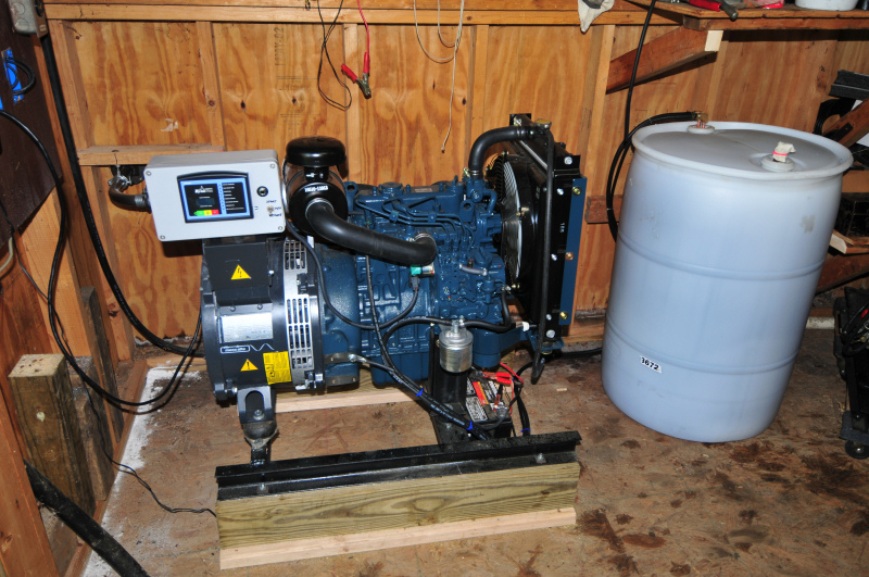

30 KW is a big unit. Nice, but running costs and purchase price are both high. I agree that an 1800 RPM diesel is the way to go. I have a 10 KW Kubota powered unit, which I can power my entire house. The only things I can't do is run the hot water heater, dryer or oven without reducing other loads. But none of these are critical loads. When I "recharge" the hot water, I shut down the AC/Heat pump for an hour or so. Otherwise I can run all 3 zones of heat/AC, refriges and freezer and all of the creature comforts (TV, PCs, lights, etc).
I would get what you need, but don't go overboard. Running costs will be lower.
paul

Paul, does your 10 kw Kubota sit in your basement? Are you venting the exhaust to the outside?
