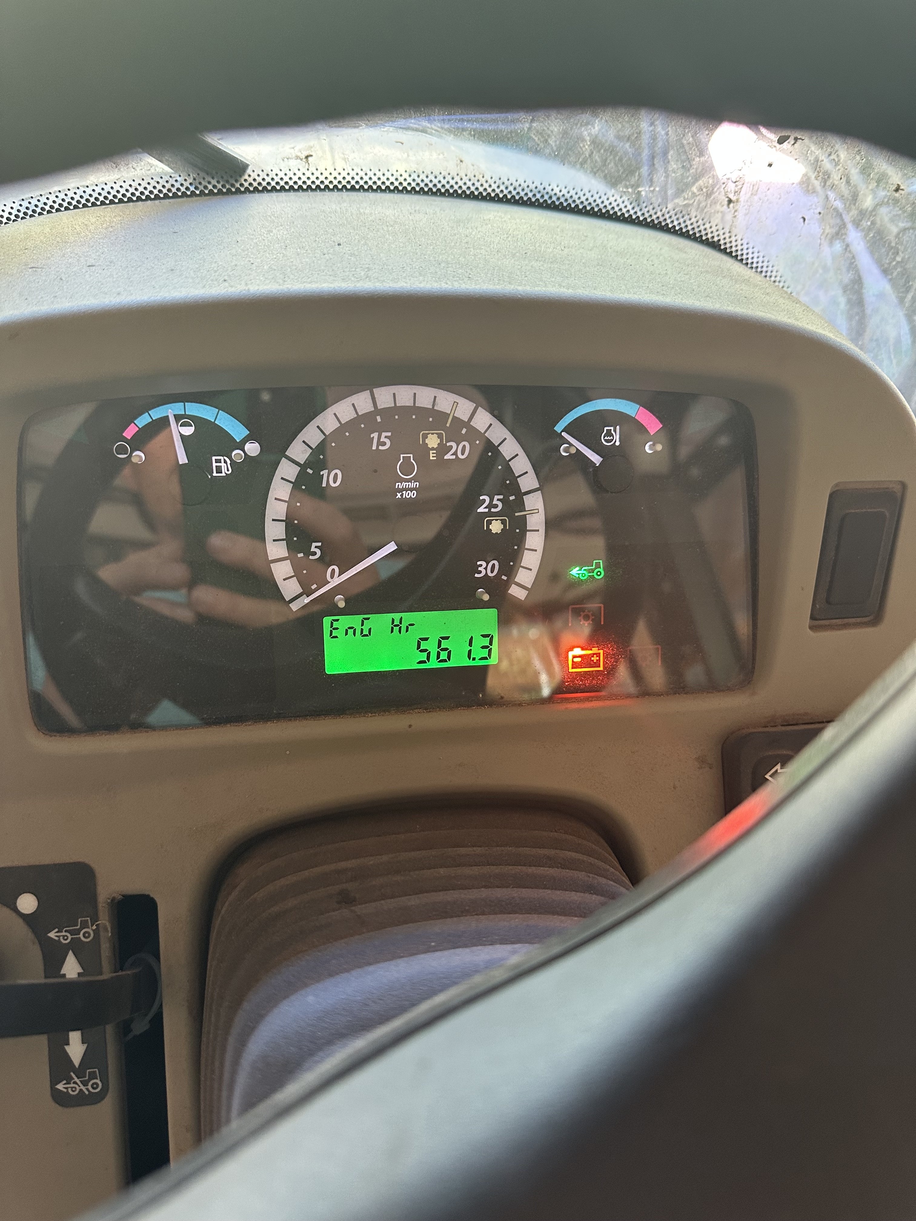

It's been 2 years since I created this post and I continue to have these issues.
I have determined that most of the error codes are fixed when I shift in and out of 4WD. Any idea why that would occur?
Today's problem is back to the one that has been around the longest... The battery icon.
The battery icon comes on and the tractor keeps running but revs down and no longer drives. A few seconds or minutes later, it kicks back in and works again.
I follow the battery ground back and am measuring over 13v at each junction back to a plate where the battery lines then distribute everywhere. I don't see any issues. Trouble is that, from there, everything is so tight that there is practically no way to review every wire.
Can anyone comment on how to systematically go through the wires and grounds? I don't even know where to look for these? Obviously the front ground by the battery is easy to find but where would I find others?
Thanks ahead for any help that can be given!

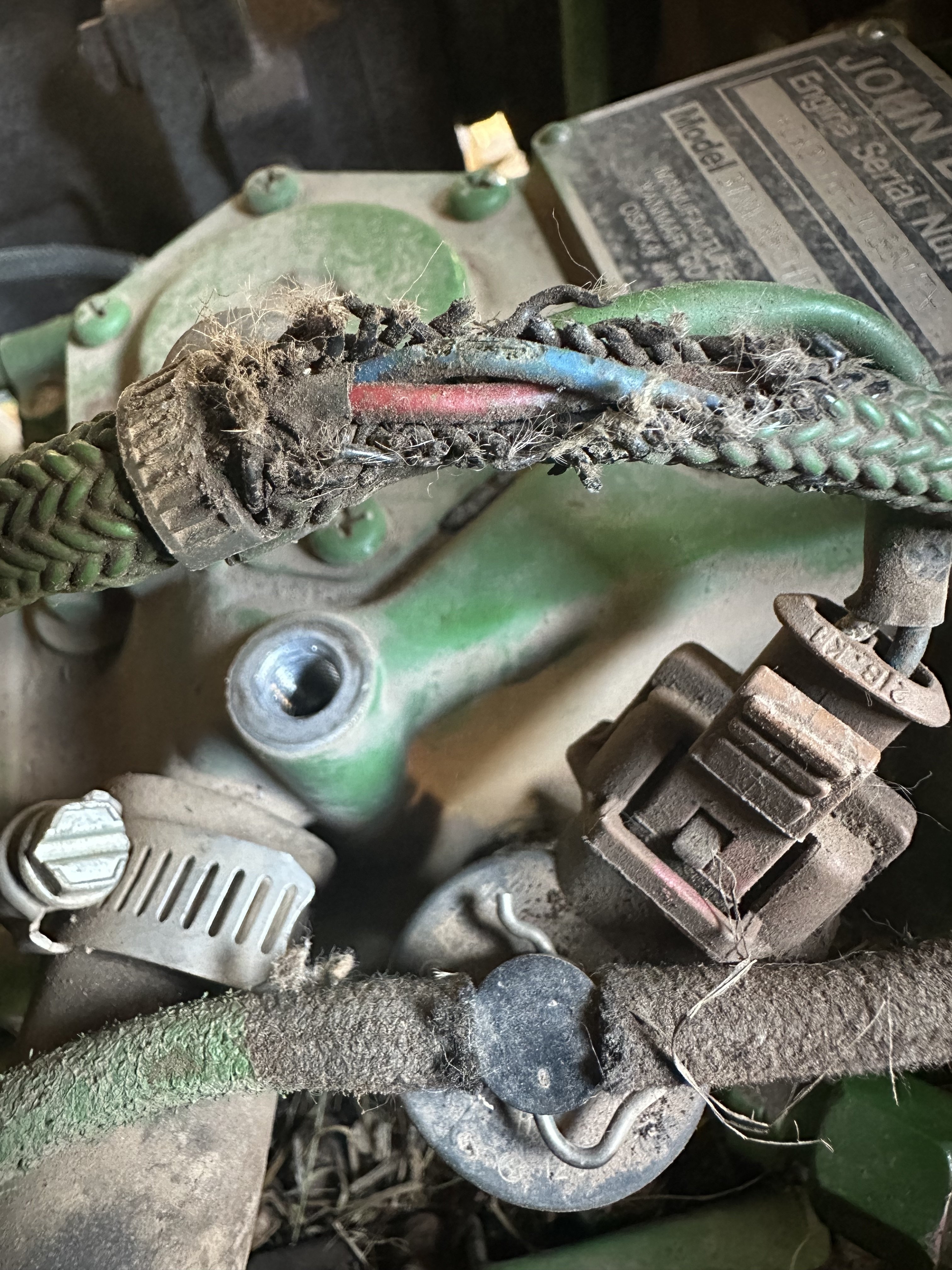

Hi Dodge Man,
Yes, I've load tested the battery and tried another battery as well. I've cleaned the main ground next to the battery and the fusible link connections and added dielectric grease.
I have been searching and have found signs of mice. Ugh.
Would something like the attached actually cause this issue? One wire is chewed a bit. But it doesn't look like the wire is making contact with anything, so would that even cause the issue?
Thanks!

/ John Deere 3046r Error Code Plague #10
If I zoom in on your picture that wire looks a little corroded but I’m not sure. The outer wrap being gone isn’t an immediate problem but I’d fix any damaged wire with a new splice and rewrap it. If you have that wire damaged there is a good chance you have more. It can be a ***** to find because it can be hidden sometimes.

/ John Deere 3046r Error Code Plague #12
I would look close to where the linkage is for the 4wd.
It leads me to believe that 4wd linkage or lever is moving something. Maybe a quick connect or such.
The 110.09 code is an open circuit to the coolant temperature sensor.
