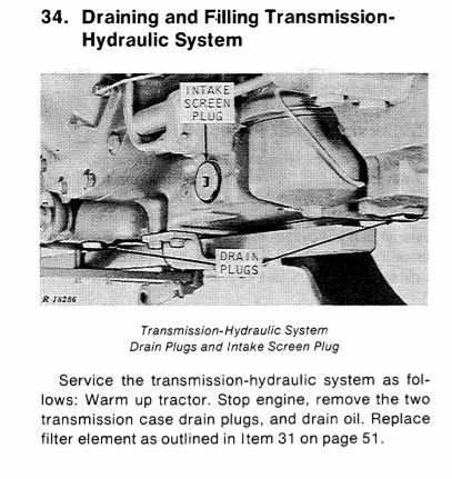

Welcome to this forum.
As you mentioned JD industrial tractors with hyd reverser have a long history of a pin(item 1) failing in shift control mechanism on reverser valve on RH side of clutch housing.
If hyd filter hasn't been changed & trans oil suction screen hasn't been checked/cleaned recently I suggest to perform that task. Hyd oil needs to be drained to check screen.
