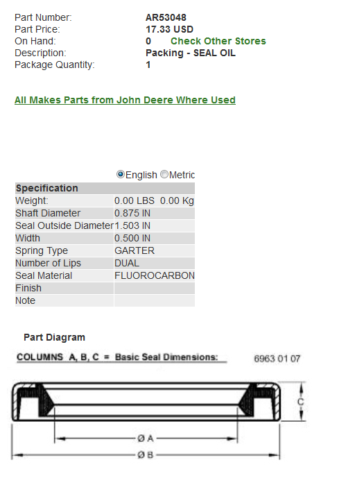

I have the open center power steering setup on my 301a, i have replaced bushings and seals TWICE, and it still leaks hydro fluid into crankcase. I ran it for about 15 minutes and it had already dumped about 1 gallon of hydro fluid into crankcase....

What condition is pump shaft?

I used a mike on the shaft and it isnt worn, the pump works great, has great pressure, but its leaking, i checked the return side of steering valve, to make sure there were no blockages, and i have good pressure there as well...

I can only find a single lip seal, but i think i need a double lip seal...

Local JD dealer should be able to get a dual lip seal. FYI your tractor must be a 300 not a 301A because 301A has only closed center power steering with no engine mounted pump
