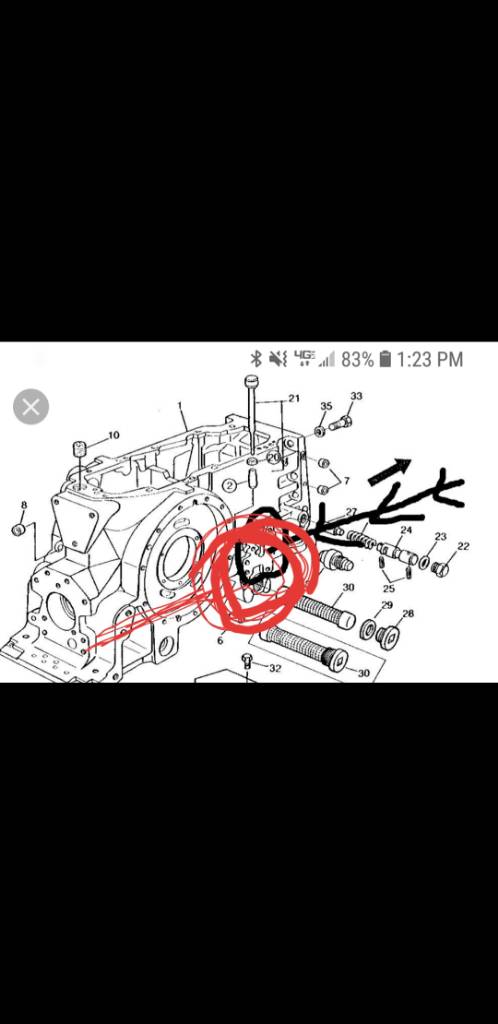

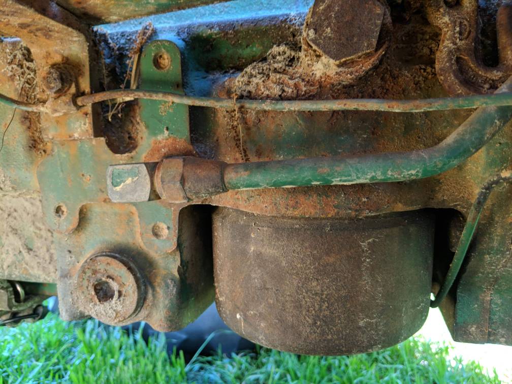

   / John deere 300 hydros
This is what my 300s trans looks like, it has 3 bolt holes for pressure control valve but does not have the second hole....received_2292755624272644.jpeg
   / John deere 300 hydros #6
Yes your tractor must be below serial number 45199. You can get by without installing pressure control valve or install valve & see what happens. Either way won't cause 3 to operate correctly
