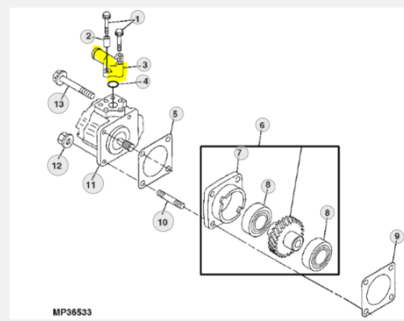

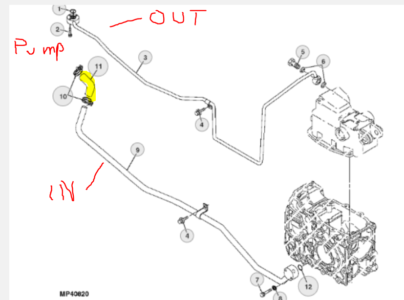

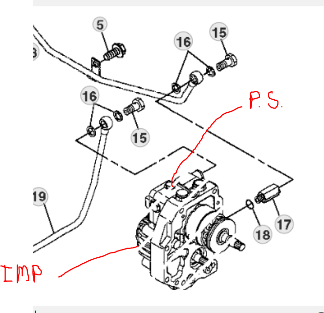

I think you are correct, two pumps, one for PS and one for implements.
Drawings are Implement pump, both pumps, lines to implement pump.
Check the elbow, highlighted in yellow, for collapsing.
Steel line from implement pump is one that will be output.

Well folks I finally found the problem! There is a seal inside the hydraulic pump (back side) which was blown.
It is the one which wraps around the two shaft ends (if that makes any sense) and prevents the hydraulic oil from diverting from the inlet/outlet portion of the pump.
