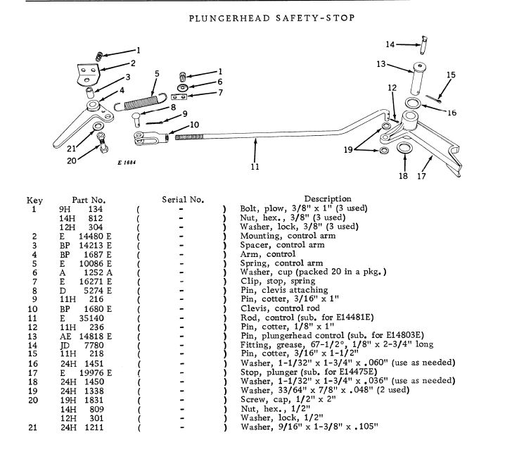

The most important thing to check is the safety dog spring.(Part# E10086) If the dog is stuck,or spring is bad and anything happens,the plunger can hit the needles and bust up everything.
I don't have my parts manual yet - is this the spring/rod gizmo that is underneath the chamber back by the needles? Do you check it by pulling the rod and making sure it snaps back quickly? What you have mentioned is my greatest fear - having parts crash into each other that ought not to do it.

A good operating PH stop is a must have to protect the needles.
/ John Deere 24t - any difference in years/models? #11
Barry
Correction: Unless needles or needle frame is already bent there's no way that plunger head can contact needles and bend them. Hay or some other obstruction can bend needles but not the PH.

There are many ways the PH can hit the needles-that is what the safety dog is for.If the needle brake slips and lets the needles slip back in-BAM! If a chain breaks and leaves the needles in the chamber-BAM! In my case,the roll pin in the rod that pulls the needles back to the park position sheared(14T) and left the needles all the way up and my safety dog spring was broken_BAM! Destroyed the needles,needle frame,and one of the knotters.
Barry
You're missing my point as there's not MANY or ANY way PH contacts needles!!!!!!! The needles travel up through 2 slots built into plungerhead and if the needles get bent from anything,anything at all it's not from the PH contacting,touching the needles but rather the hay the PH is pushing on a compression stroke. Think about what I'm stating.

6 of 1 half dozen of the other, the force of the plunger head stroke is what breaks the needles and knotters if they are up when they shouldn't be.
Barry
Jim
/ John Deere 24t - any difference in years/models? #20
slowzuki
There are rare exceptions but without hay or other obstruction in the bale case the needle to plunger head timing can be wrong but the needles will not get bent or broken when cycled. As I previously stated needles travel up through slots built into the PH!!
