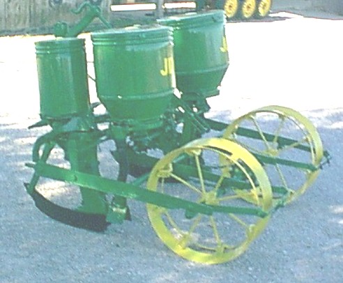

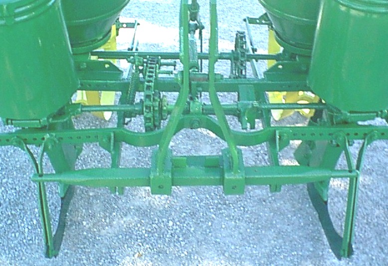

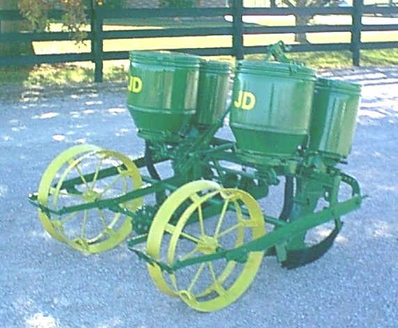

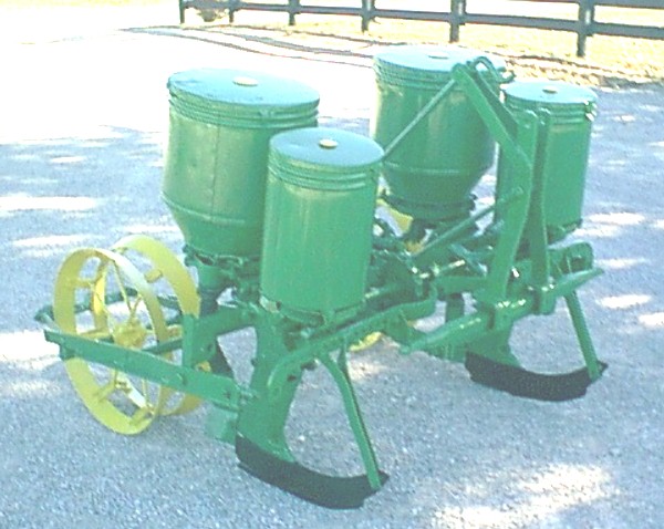

We just got this John Deere 246-247 out of the shop today. Ken Sweet

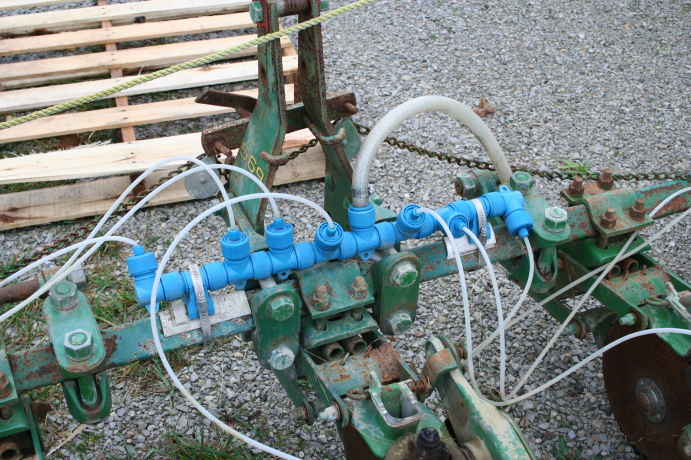

Hi Jim, I do not want to hijack the OP's post but I was thinking of trying liquid fertilizer next summer. I picked up this old 7 row 71 a few weeks back and it is set up with a manifold and tubes to spray phosphate right in with the seed. The fellow I purchased it from said he used it with corn and soybeans for years with this setup. Thought some would find this setup simple and helpful for liquid fertilizer.

Yes, looks good. Mine is a little simpler as I only use a 1 row planter. Some care needs to be used when adding fertilizer in furrow with seed as some fertilizer will burn seed. Bigger tank than my 15 gallon would be in order for 7 rower.

I bought this 7 row planter for the tool bar. I'll never use a 7 row planter for the 2 acres of corn I plant. I'll put my already refurbished 2-row 71's on this tool bar after I cut it down.
