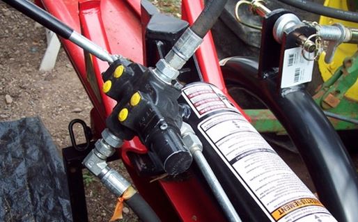

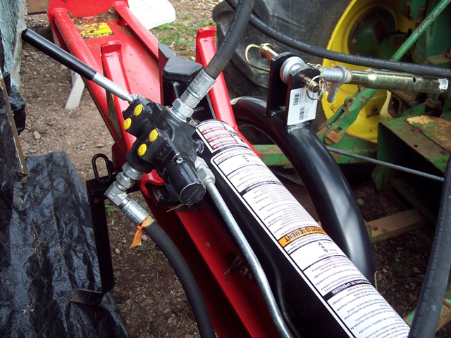

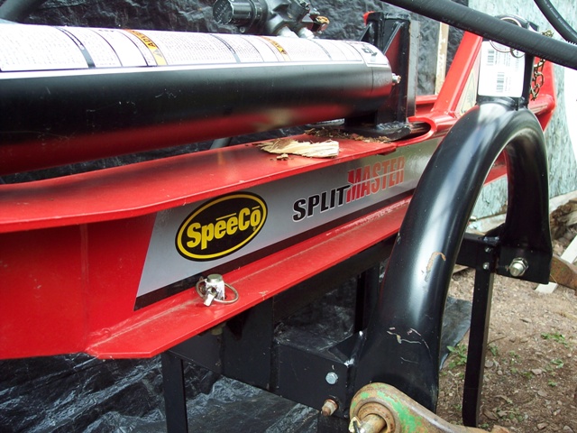

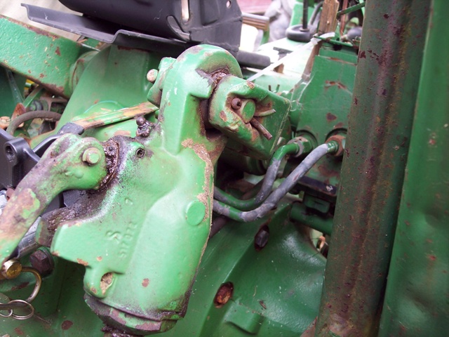

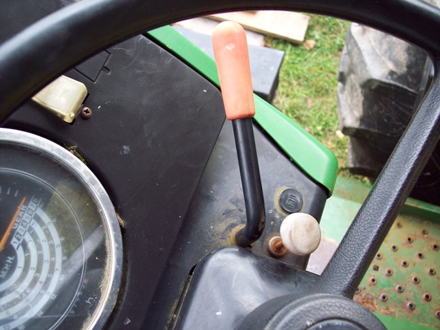

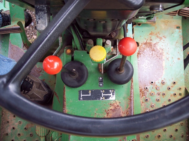

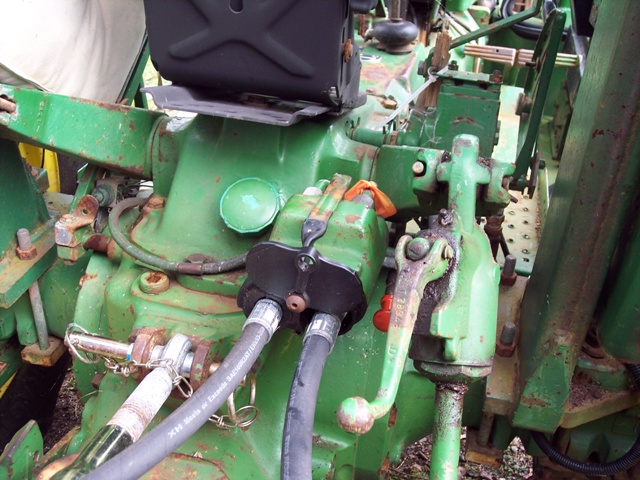

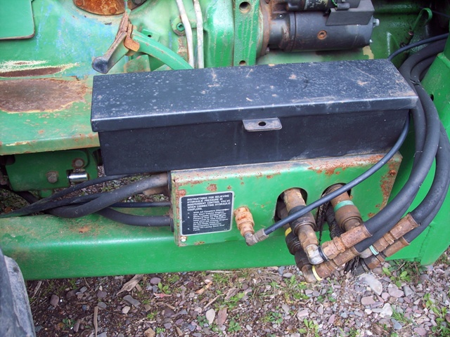

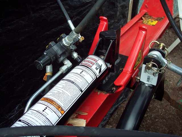

I'm back and have a few photos to show you and perhaps you can educate me some, please. 1014 010.jpg1014 003.jpg1014 004.jpg1014 005.jpg1014 007.jpg1014 008.jpg1014 009.jpg

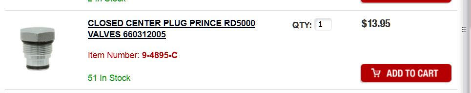

It appears the log splitter is hydraulic powered from tractor rear remotes. If splitter valve is an open center valve it will cause the 2350's closed center hyd pump to run out of oil and cavitate. Long/short story the splitter needs a closed center valve or at least a CC conversion plug if the splitter valve will accept it to correctly operate on a JD 2350.

Tx Jim, is that closed center valve on the splitter one you can see above the cylinder at the end (above the first red band on that cylinder)? That valve is closed.
   / John Deere 2350 tractor under powered PTO need info on hydraulics on this #14
Valve being closed in photo has nothing to do with if valve is closed or open center.Here's a simple test to determine if valve is CC or OC. Does valve have ports marked in or pressure & out or return? If so remove out hose male quick coupler from hose attached to splitter valve return port. Aim hose in oil filler hole on rear of tractor. With splitter valve in neutral engage tractors hyd control valve with engine running to power splitter valve,if oil flows through splitter valve and out return hose the splitter valve is open center and it's wrong valve for the 2350.

We can at least say it has nothing to do with the PTO. Do the other hydraulics on the tractor work OK? HST? Front loader? 3-pt hitch? If so, I'd suspect the problem is in the splitter.
#17
My friend was here a while ago and I read the posts to him and he also agrees that it is more likely with the splitter, but as it was getting near dark, we didn't drive to where the tractor is to try anything today, and he's away tomorrow (appointment). The front loader works great, so as you (s219) say it may be mostly a problem with the splitter. Any ideas on what we might try to remedy this? Other than the test that Tx Jim suggested.
