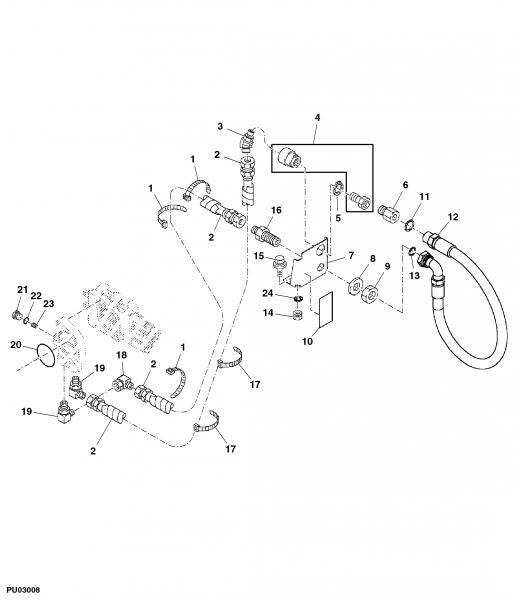

I'm sure this has been discussed numerous times on this forum but I can't find it. I want to install a power beyond for my tractor. Deere wants over 500 dollars for a kit. Just the kit, install is more. Just a simple hydraulic outlet and return for a small back hoe. Any ideas for a less costly alternative?

You can do it yourself, you will need the hoses, fittings, QD's, and the "plug" (#23) that goes into the SCV spacer block. The JD part number is BLV10381 for the entire kit, and is closer to $400 at many places, not over $500.
This thread has some details on the parts, it's the same as your 2320 needs even though it's about a 2520.
https://www.tractorbynet.com/forums/hydraulics/100228-adding-power-beyond-3-spool.html
REAR AUXILIARY HYDRAULIC KIT
Cart key PART NO. PART NAME QTY SERIAL NO. REMARKS
1 CH16579 Tie Band 3
2 M808059 Hose 2
3 LVA803382 Elbow Fitting 1
4 AM105466 Hyd. Quick-Connect Coupler 1
5 M42702 Snap Ring 1
6 AM105467 Hydr. Quick Coupler Plug 1
7 LVA803353 Bracket 1 (SUB FOR LVU802956 OR LVU802012)
11 R26375 O-Ring 1
12 AM105465 Hydraulic Hose 1
13 T77857 O-Ring 1
14 14M7274 Nut 2 M10
15 LVU800471 Screw With Washer 2 M10 X 30, (USE WITH LVU802956)
16 M808273 Fitting 1
17 R44302 Tie Band 2
18 M809071 Fitting 1
19 M808055 Fitting 2
20 CH17260 O-Ring 1
21 M808034 Plug 1
22 M800633 O-Ring 1
23 PT13744 Plug 1
24 12M7066 Lock Washer 2 10 mm
