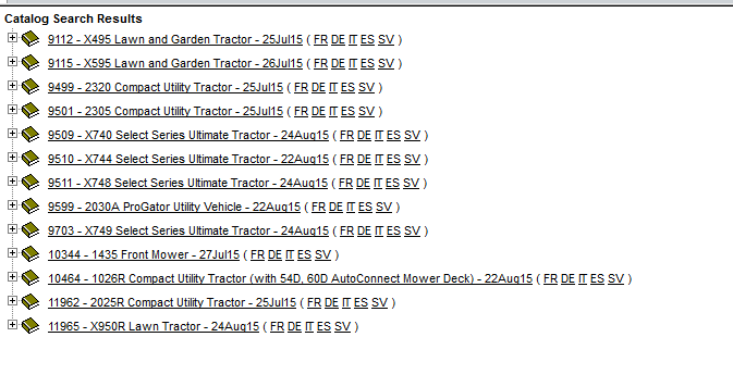

The 2305 has a Yanmar 3TNV76. According to tractordata the 1026R has the same engine. 2210 also has the same as stated above.
/ John Deere 2305 Engine Replacement? #11
Some more - X740, X744, X748, and X749, from 2006 -2010. The X495, and X595 after 2005. There might be more, I just did a quick look through tractordata. I've seen engines and parts for these turn up on eBay also. Tractordata has the serial number breaks for when they changed engines in each model.

I've found conflicting info for the 2210 engine online. Wonder if it had a change during production or just bad info online. Most of the models I listed had different engines at different times which is why the serial number of the unit is very important.
/ John Deere 2305 Engine Replacement? #14
Here's the list of models that the engine will interchange according to JDparts.com and 2210 isn't in the list.
