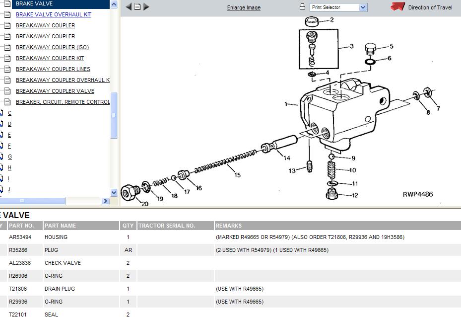

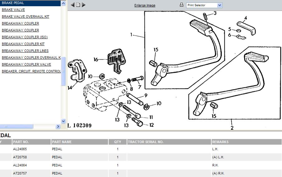

Seems odd to me that both brakes work together in this drag effect. I believe the linkage is independent from the brake pedal back to the left/right axles, so to speak. But there is a brake valve where the right left brakes are activated, so maybe that is a place to look for this dual effect. One pic shows the brakes and the valve (dotted) and the other the valve. There is a brake valve kit with o-rings and such, so maybe there is some wear and tear that this valve needs. That I don't know.
Regards the 4wd being engaged or not while this happens....what you say?

4wd is not ingaged the brakes are hyd. they are feed from the return oil of the steering motor when you press the pedal this feed the brake piston.

If they release after a few minutes, I almost has to be in the brake valve/master cylinder.
   / John Deere 2240 4WD Brakes #10
The return oil from steering does fill the brake reservoir, but at very low pressure. I can't imagine a brake valve making pressure on it's own. Maybe you've got a diff lock valve leaking past and trying to lock your diff at speed. I never tried to engage diff lock in motion (manual says not to). Is there a noise like maybe a gear binding up? What transmission?
