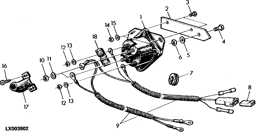

Hi I have been working on a John Deere 2155 that won稚 start I replaced the Solenoid on the starter it still won稚 start now I have no power to my ignition switch help thank you

First check ground at chaccic....then....fuses....circitbreaker....neutral startswitch
   / John Deere 2155 won稚 start #3
Welcome to TBN
If not already performed I will recommend relocating negative battery cable connection from battery box to starter mounting bolt or engine block. I wonder if your tractor has had a JD starter relay kit(see photo below) added? Neutral start switches have a history of loosing some movement of ball by shift rail. One can remove a sealing washer or 2 on switch to sometimes gain better connections on switch. BTW switch is located on top of rockshaft housing.
