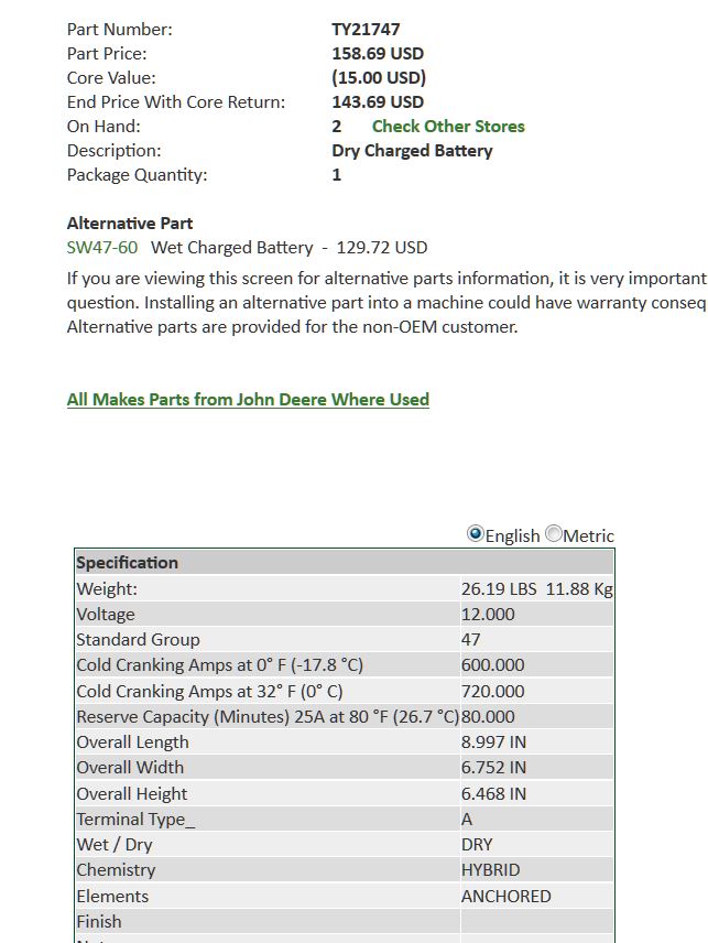

   / John Deere 2155 Battery size #3
This is what's listed for a 2155 with dual batteries. These are 55AH batteries . 88 AH battery is shown with only one battery.

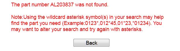

The battery compartment could the same size on the three cylinder 2155 and four cylinder 1640? The four cylinder specs larger batteries which will be welcome even on a three cylinder on a cold day, if they fit.
AL203837 Wet Charged Battery 12V, 66AH, 300A
   / John Deere 2155 Battery size #5
This disclaimer comes up when AL203837 is inserted in a JD parts search on JD's website. b&d isn't a dry charged battery supposed to have a better self life than a wet charged battery?

Wet is fine if used in a month or two . Or if it's trickle charged monthly. True the safest and freshest battery is the "dry charged " unit.
