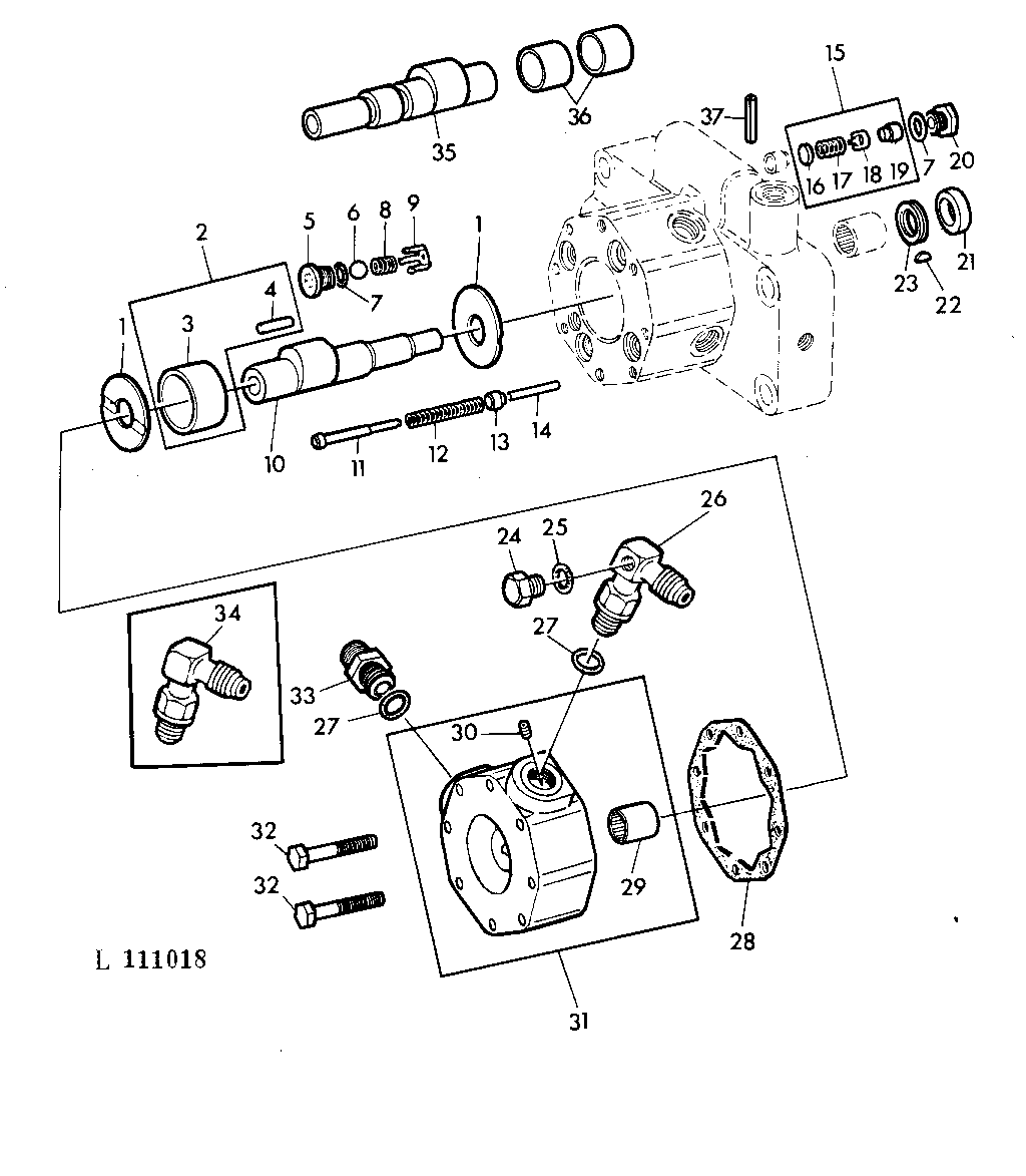

   / John Deere 2120 Pressure Relief Valve Location #2
I doubt very seriously that your tractors pressure relief valve is the problem for your tractors inability to raise a rd bale on the FEL but here's a parts photo of the valve. It's on the RH side of trans case behind the hyd filter. HAVE YOU CHECKED STAND-BY pressure? It should be 2250 but 2350 is better.

Hi Tx Jim, Thanks for responding!
I am going to build a gauge this week to test. Is the best place to test off the pump or using the rear remote?
I thought that part on the tractor was to ensure that the tractor always had power steering when using other attachments with how the fluid would flow in priority? With that said, maybe we are on to something else as I notice sometimes if I'm standing still using the loader and I try to turn the steering wheel its as if I don't have any power steering. Its super hard. And as soon as I start to move I get my power steering back. Using the loader sometimes, and I mean maybe happens 10 times a year, jerks the steering wheel around so maybe this part you are showing me needs a rebuild and not a shim kit?

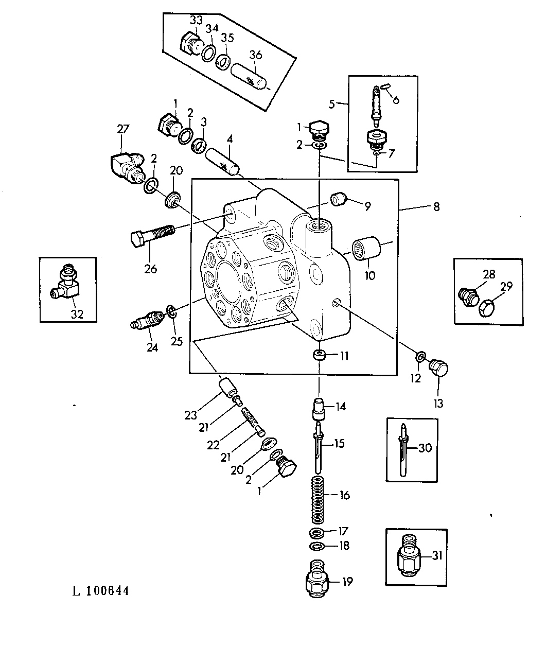

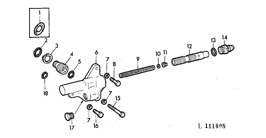

Hi Tx Jim; Which number on either of these diagrams is the adjustment screw to turn if that's what I need to do? This weekend won't be too cold so I'm hoping I can get to it then.

   / John Deere 2120 Pressure Relief Valve Location #10
#19 2nd photo is the adjustment screw for SC valve
