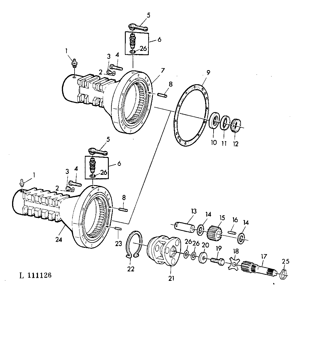

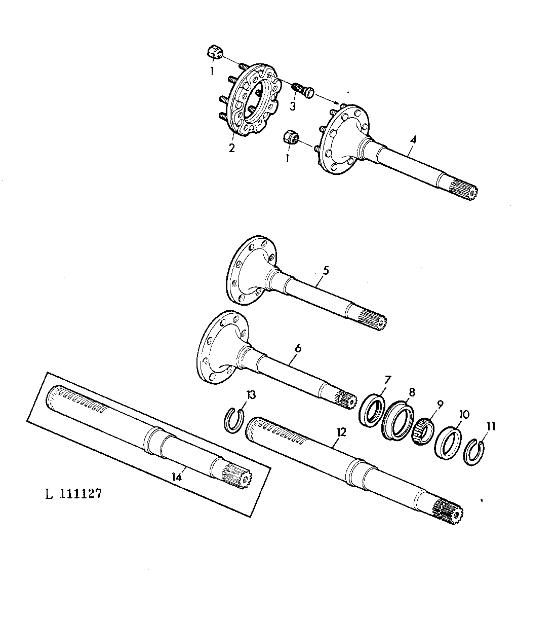

Hello,
Can someone help me with a service repair book for this model of tractor JD 2120 from '71 or with the explanation of how to change the back shaft from the wheel?
Thanks!
   / John Deere 2120 from 1971 repair book #2
Which shaft are trying to change(pto or rear axle or load control)???
Rear axle, it starting to leak.
   / John Deere 2120 from 1971 repair book #4
Final drive housing must be removed from tractor to replace inner seal.

   / John Deere 2120 from 1971 repair book #7
If your tractor has regular final drive these are the parts to repair leaking rear axle.
T21419 Gasket
AL39391 Seal
