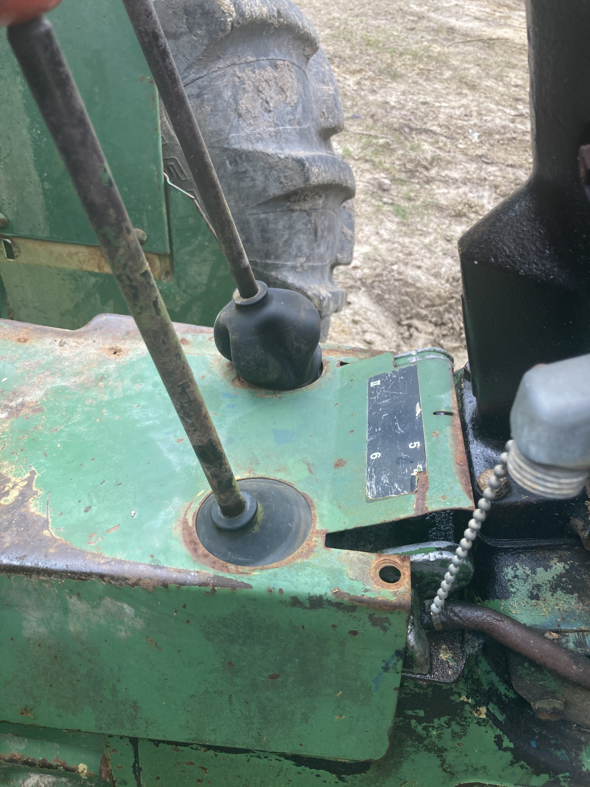

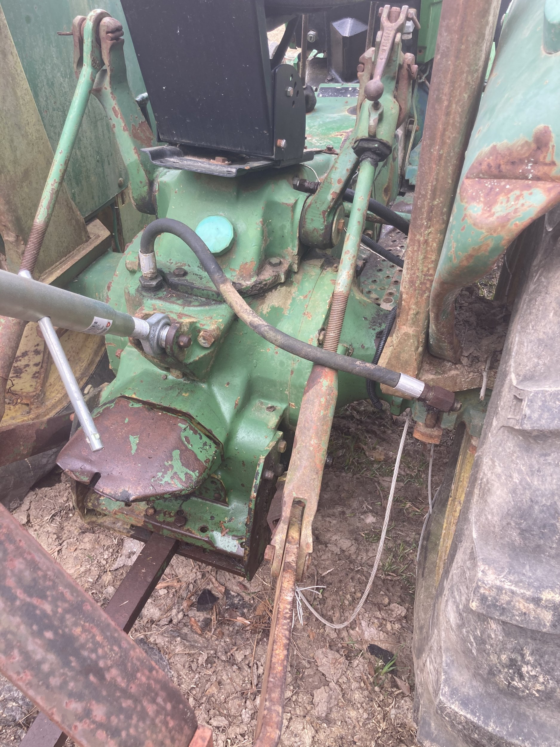

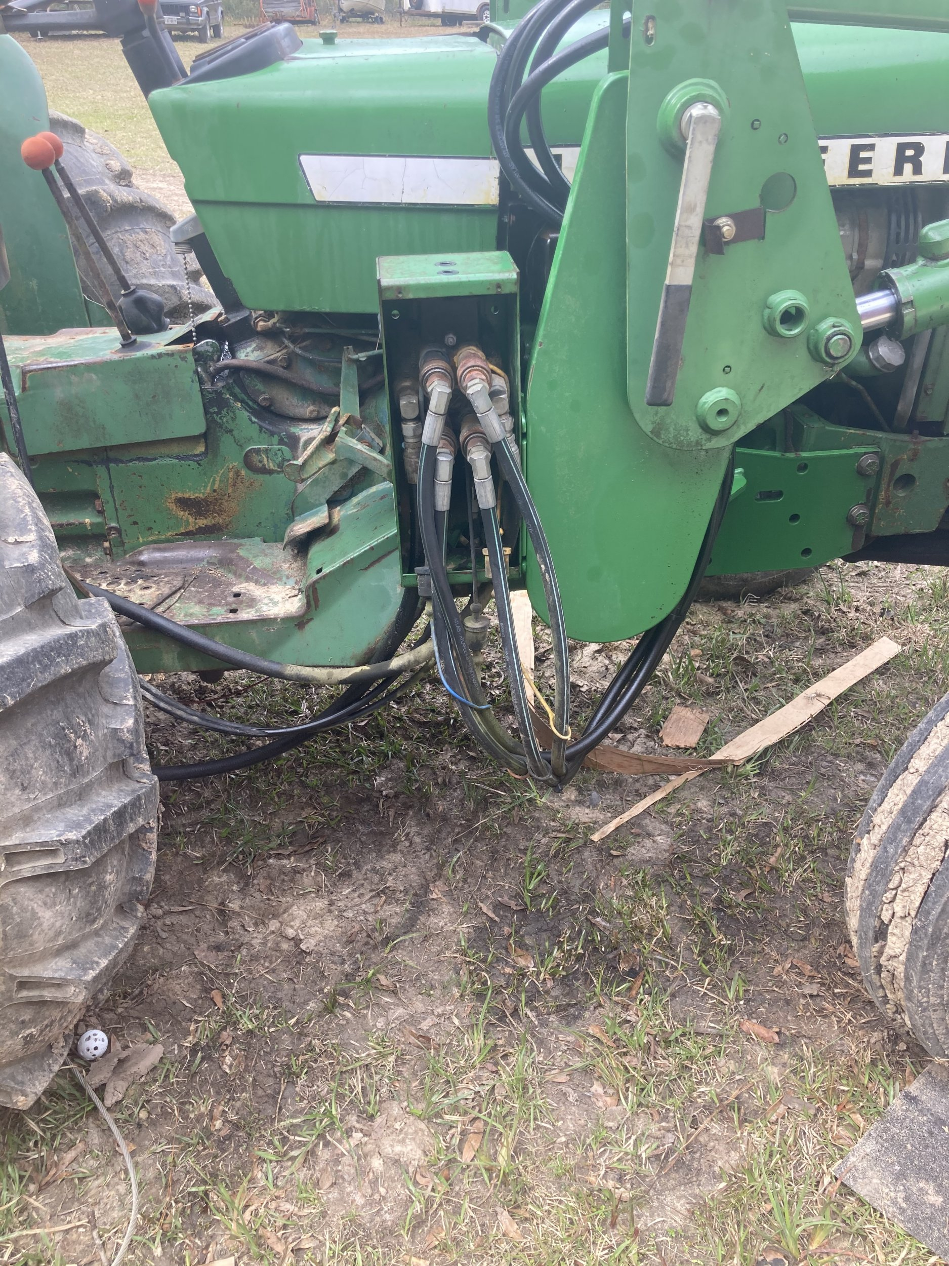

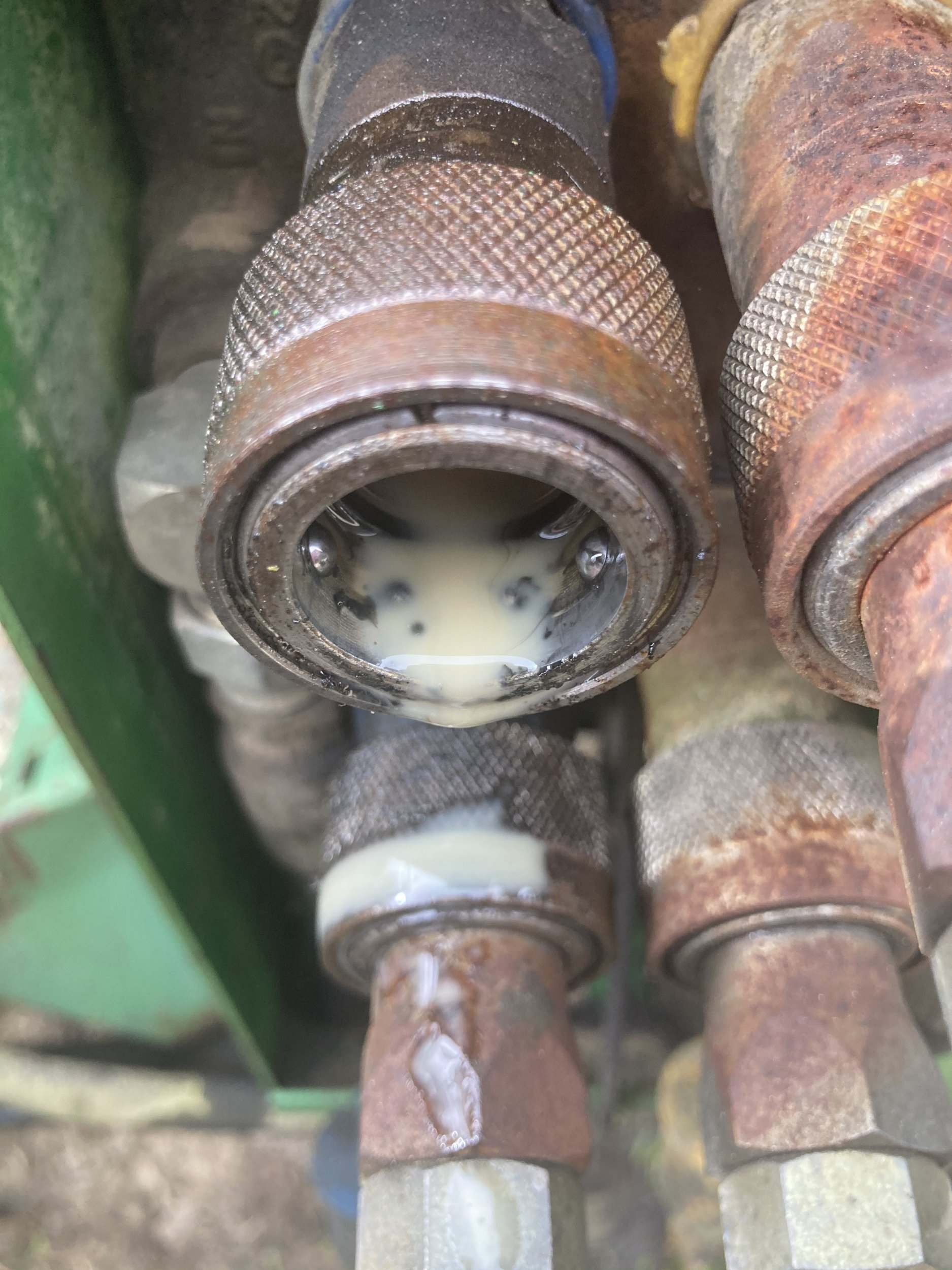

These are the pictures. I did not have time this evening to do the test that you mentioned, but hope to do that tomorrow night. Everything appears to be hooked up properly for the front and loader as all of the functions match what they are supposed to do on the control. I am also including a picture of one of the lines pulled off so you can see the state of the fluid that is in there now, even after they supposedly drained it and filled with fresh fluid. I also have pictures of the rear remote as well as the hose that I assume was the line that went back to the transfer case from the rear remote. I do not see where it was tied in, but recall seeing a line with a tee in it on the ground near where the remote was laying when I stopped to check on it the last time.
Unfortunately, I don’t know any history on this tractor that will tell me potentially how long it has been run with the fluid in that condition.

You should remove hose in photo below & install a 1'' pipe plug. Sometimes a hose similar to one in your photo is utilized for a hyd oil return on an implement such as a hyd post driver. A hose attached to tractor similar was utilized on older 2040's than your tractor for control valve for OC FEL control valve.
Also I recommend changing that milky looking hyd oil ASAP. Check breather in hyd filler cap behind seat to be sure it's not clogged with dirt. Milky oil indicates presence of H20 which is ""very detrimental"" to rear axle brake pads. If you park your tractor outside not under a shed I recommend covering gearshift area

I’ll grab some oil and a pipe plug this afternoon and change both.
I’m assuming I will not be able to get all of the oil out of the lines just by draining. Is there an additive or something I can use in the new oil to help finish getting the remaining moisture out?

I agree, the line in your last picture was for a return. Not really related to rear SCVs, but added for use as TxJim suggested, a post pounder that needs a free return to sump.

Your pictures do not show where the pressure and return lines from the loader valve go to. But it does show 6 lines. OC would have 7 lines. I think they plugged the seventh port.
I am not sure what if anything can be used to scavenge the water out of the hydraulic system. The loader will also contain contaminated fluid. It might take several flushes to clear all the water out.

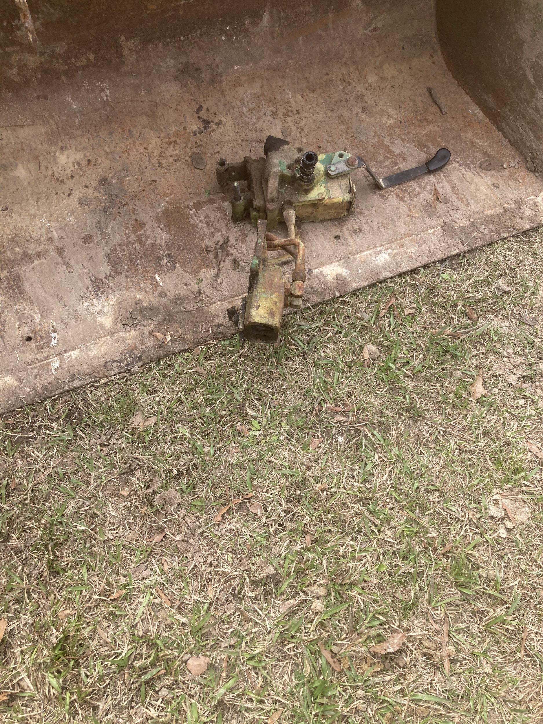

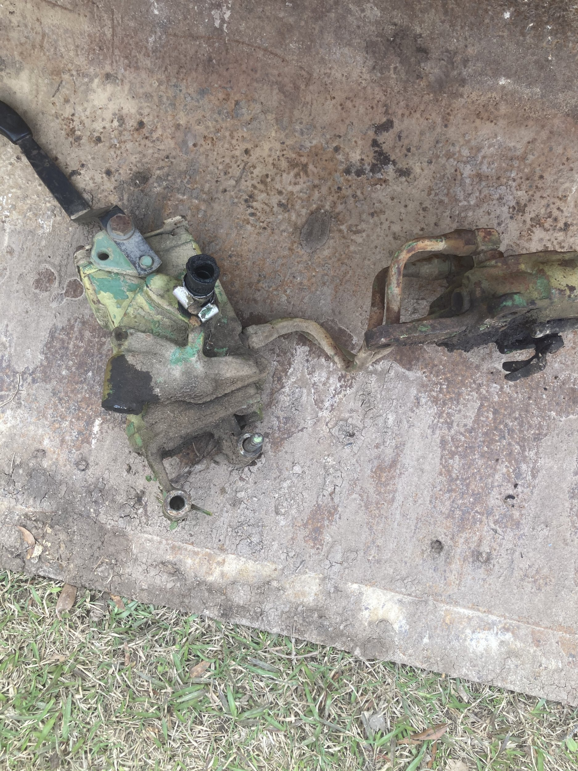

I did get the rear remotes back - for now, I’ll just clean them up and store them in the barn. This is how I got them...

That scv in photo below was designed to fit your closed center hyd tractor. It should worth several $100. Open center control valve had different appearance.
