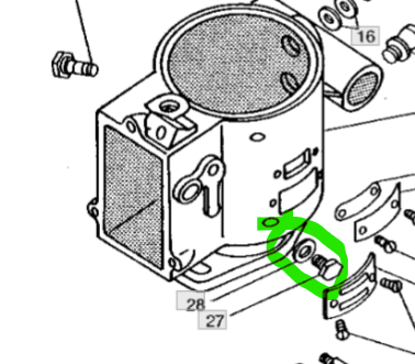

John deere injector pump don't work
   / John deere 2010 don't start #2
Welcome to TBN
Do you have good fuel flow from tank to inj pump? Is fuel tank venting. How many hrs of use since fuel filter was changed? Try starting engine with bleeder screw loose on inj pump allowing fuel to escape. Check valve that fuel return line attaches to could be clogged from deteriorating IP drive ring causing too high pressure in IP body. It's possible metering valve or other internal IP parts are stuck from having to use ULSD or Bio-diesel
