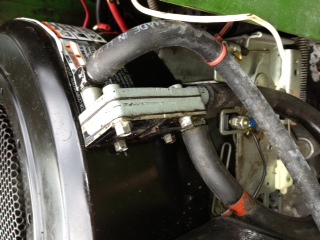

Sox3:
Our fuel pump doesn't look like the photo you sent. A snapshot of ours is included here. After looking at this your insight would be most helpful. Thanks.photo.JPG
   / John Deere 111H fuel pump hoses #7
I cant tell much from that pic. You have the hoses hooked up to it so is it not working? have you tried it the way they are hooked up?
Engine model #s would be a help.

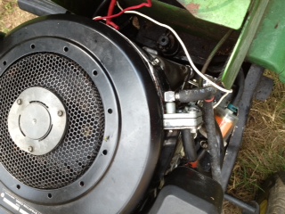

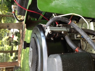

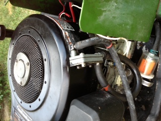

Sure, and before I forget it, thanks for your help. I am attaching more photos for you to see the piece we mean. And here are the details about the tractor and engine: John Deere C111H ID#222862; Engine model 284707, type 1026-E1, Briggs & Straton 12.0 HP.
   / John Deere 111H fuel pump hoses #9
if memory serves me correct, the fuel inlet is at top, the vacuum is pointing down out the bottom, the othe toward carb is out to carb. lke i said eariler, hook up vacuum and inlet, crank over and see if pumping fuel (into can or jar).
