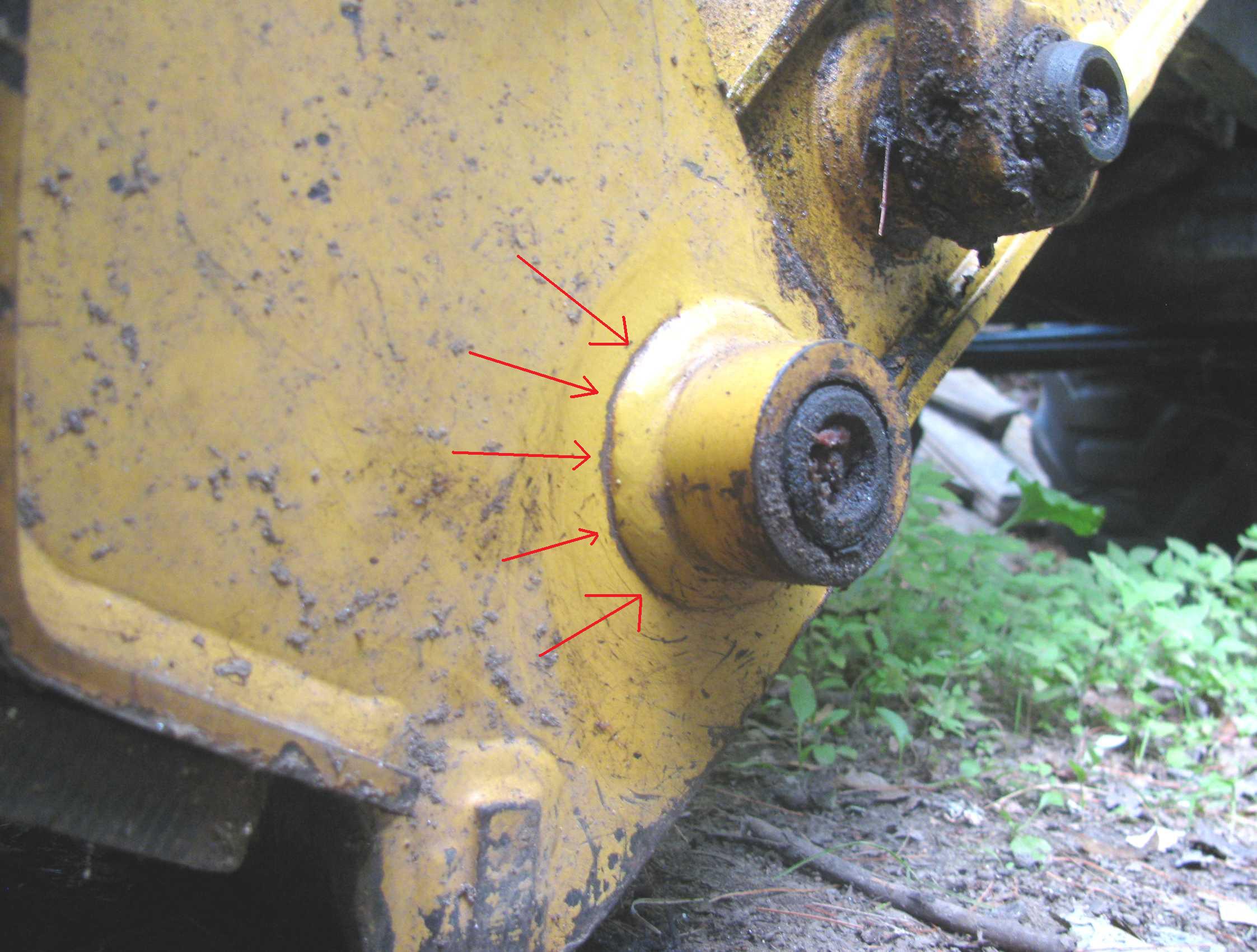

Here's the typical look! If you have the rust ring, forward side, lower Quick Tach mounting, it likely represents a crack, more visible from inside.

is this the rust ring you are referring to

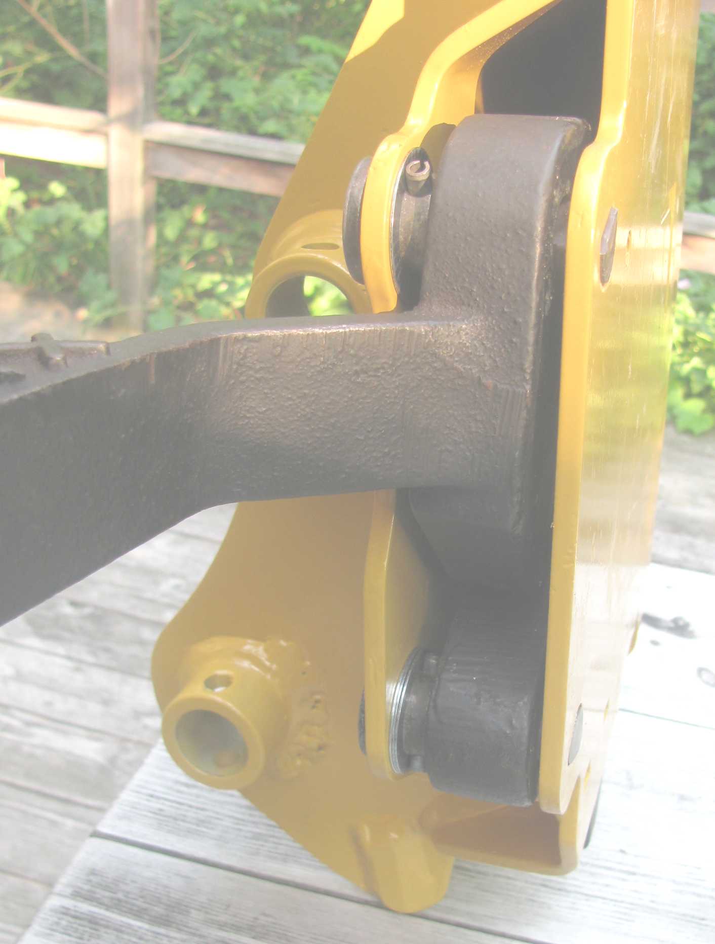

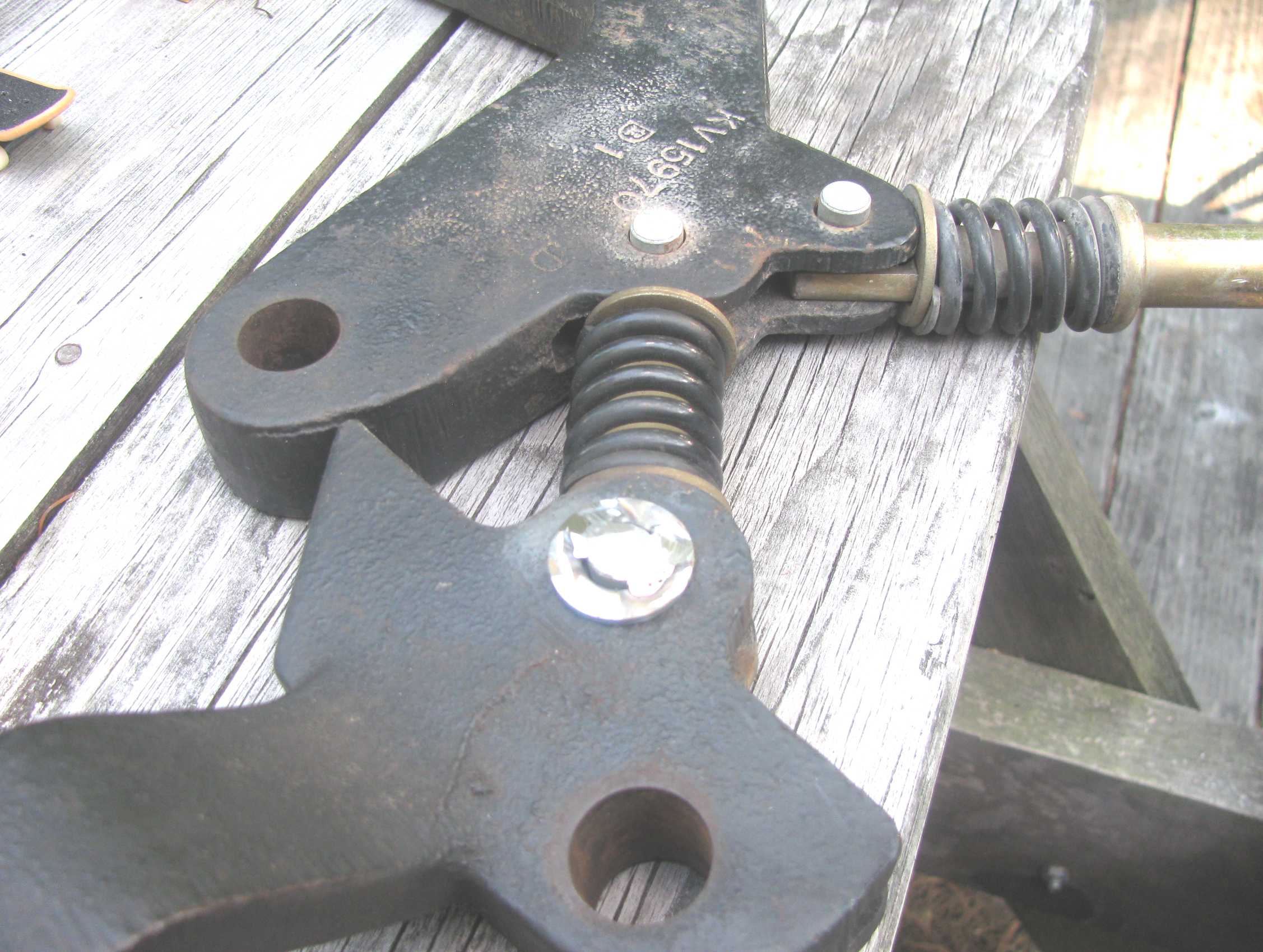

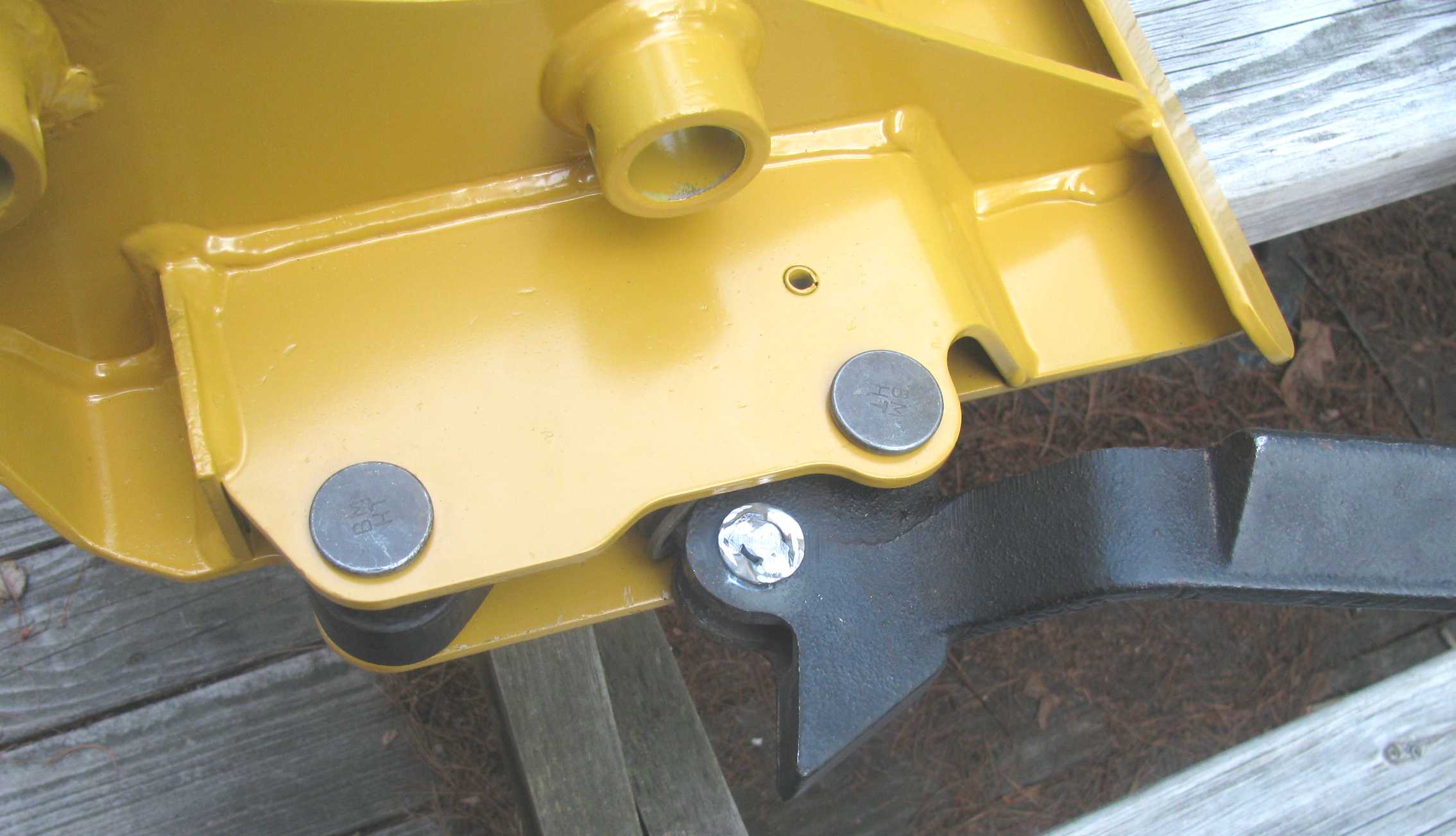

Here are my rebuilt, newer, Quick Tach plates. You may notice added weld, forward side, lower pin. I installed hardened steel valve spring shims under spring pin on pivot pins. This keeps the pin from floating. There is a lot of bending load on the pin. As it floats, it cannot come out of the far side plate (abutting the attachment) but can retract somewhat into the D-hole. The far side plate can peen around the hole because of the heavy load. Capturing that pin keeps it fully engaged into rear plate and keeps movement down to reduce wear. I used three .030" down low for the high load pin and one up top, non-load handle pivot pin. The pins and shims measure 1.03" OD/ID respectively. I tack welded a washer to the outboard weld pin to keep it from coming out. Note the longer pins per initial post.

Here is image of my original Quick Tach plate with outboard-most weld pin all but falling out, the one from the opposite side apparently did fall out. It was replaced by a bolt and nut as I received the machine. The entire set of pins was doing about the same. It's just that the inboard pins cannot physically fall out. Once again, the John Deere replacement pin is longer.

Here is image of early versus late Quick Tach plates, 2004 vs. 2006, perhaps. As you may notice, the later plates have a lot more material about the pins. Also notice how stretched my lower latch pin holes are. The latch was cocked and attachment retention was sketchy.

Lastly, here is front of machine with reconditioned later Quick Tach plates, new longer weld pins, new 10mm pins, shimmed pivot pins, everything degreased, regreased, good zerk fittings, paint touched up as required. Latching is now firm and positive. I'm much happier and am confident to not drop an attachment or have a Quick Tach plate pull out on back drag.
