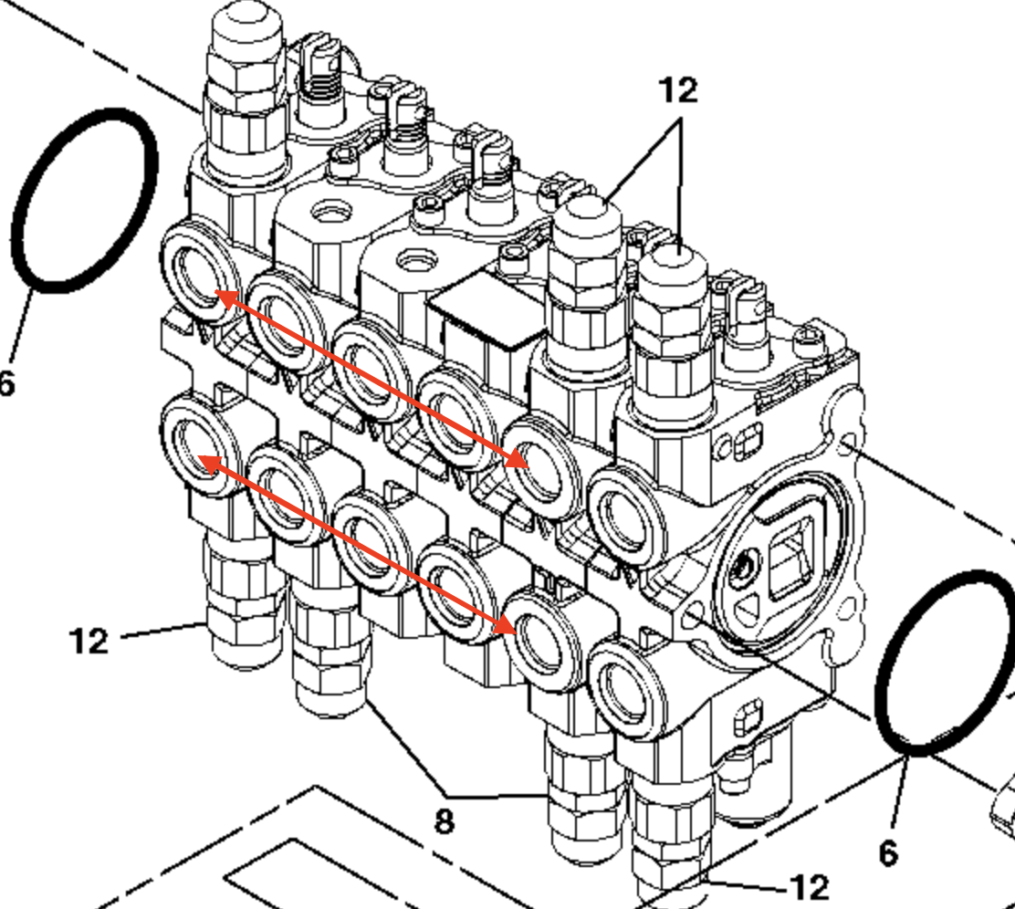

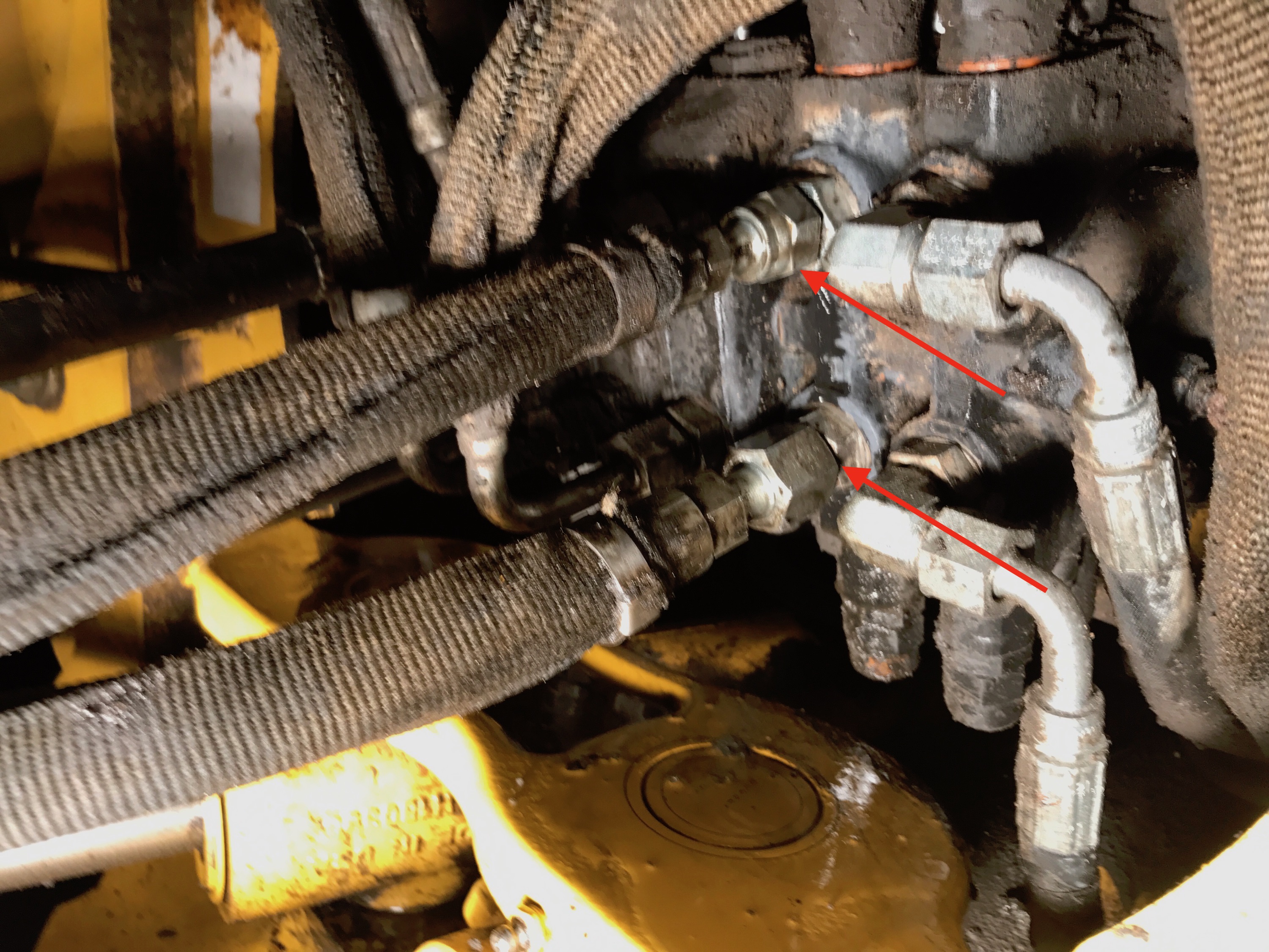

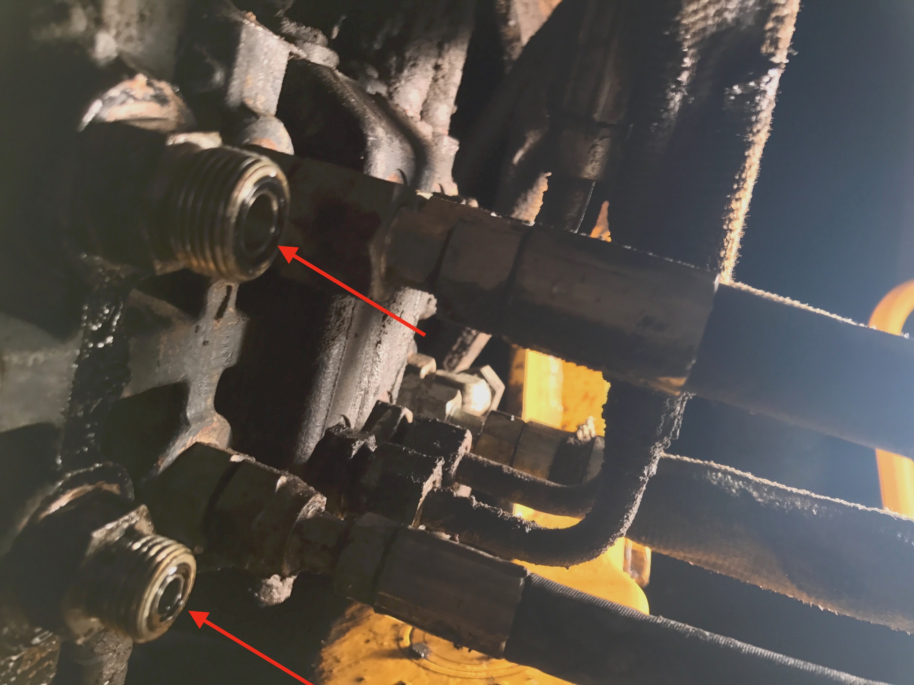

I switched my JD 110 TLB from the John Deere controls to Cat controls today. I thought I would post for those interested.
1. Park on a level surface and chock the wheels.
2. Shut the tractor off
3. Let the backhoe to the ground and relieve the pressure by operating the controls full travel with the machine off.
4. Locate the valve assembly just below the backhoe controls
5. Disconnect the 2 houses for the boom from the valve assembly
6. Disconnect the 2 houses for the dipperstick from the valve assembly.
7. Remove the fittings that are left in the valve assembly and switch the top ones for the bottom ones. Do this to both sets of hoses.
8. Place the boom hoses into the Dipperstick side and tighten
9. Place the Dipperstick hoses in the boom side and tighten.
10. Start tractor and check for leaks.
