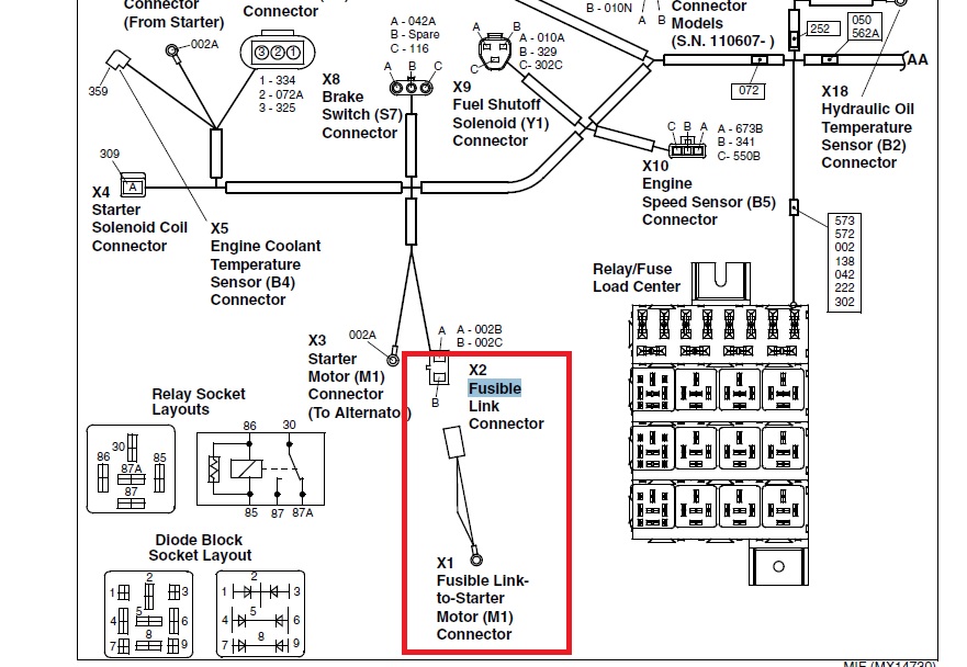

Excellent advice Dave, thank you. I will follow this next week when I get some time. I hope you're right. The only way I can see to get at all the wiring would be to remove the r-rear tire and render assembly to access it. Pain. I do have the factory manuals but there are no photos of where stuff is located. Do you happen to know where exactly that fuiable link is? I see it on the schematic but there's no reference in any photos.
From my look at the WSM, the fusible link should be right at the starter. Connection X1 is the fusible link to the starter's battery terminal and connection X2 is to the wiring harness.
