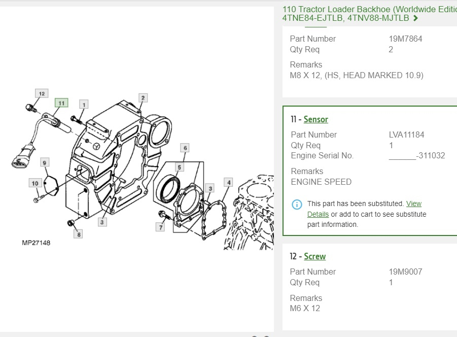

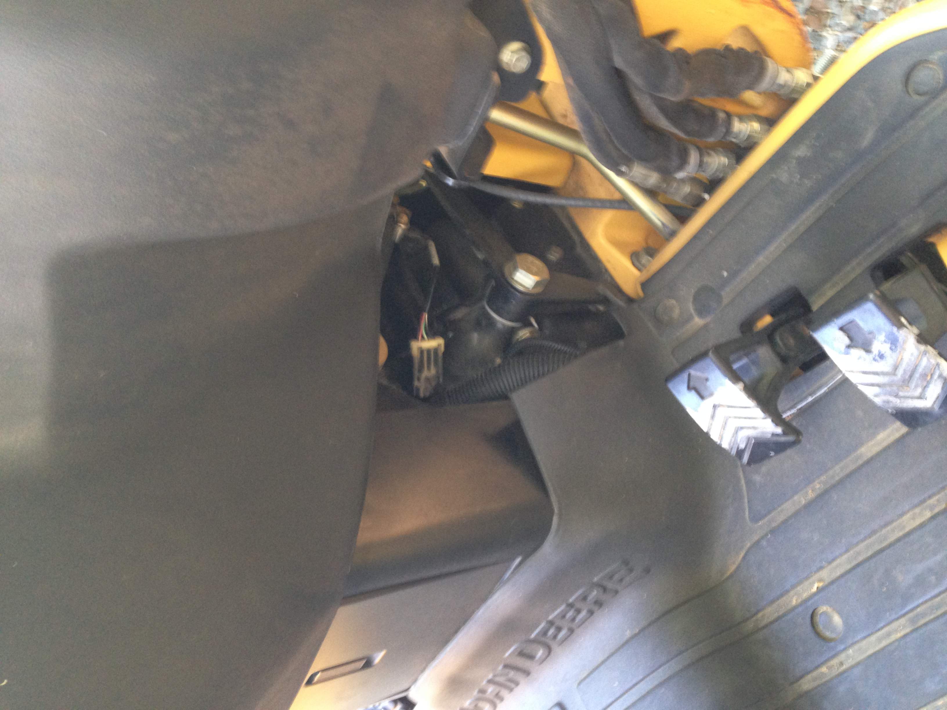

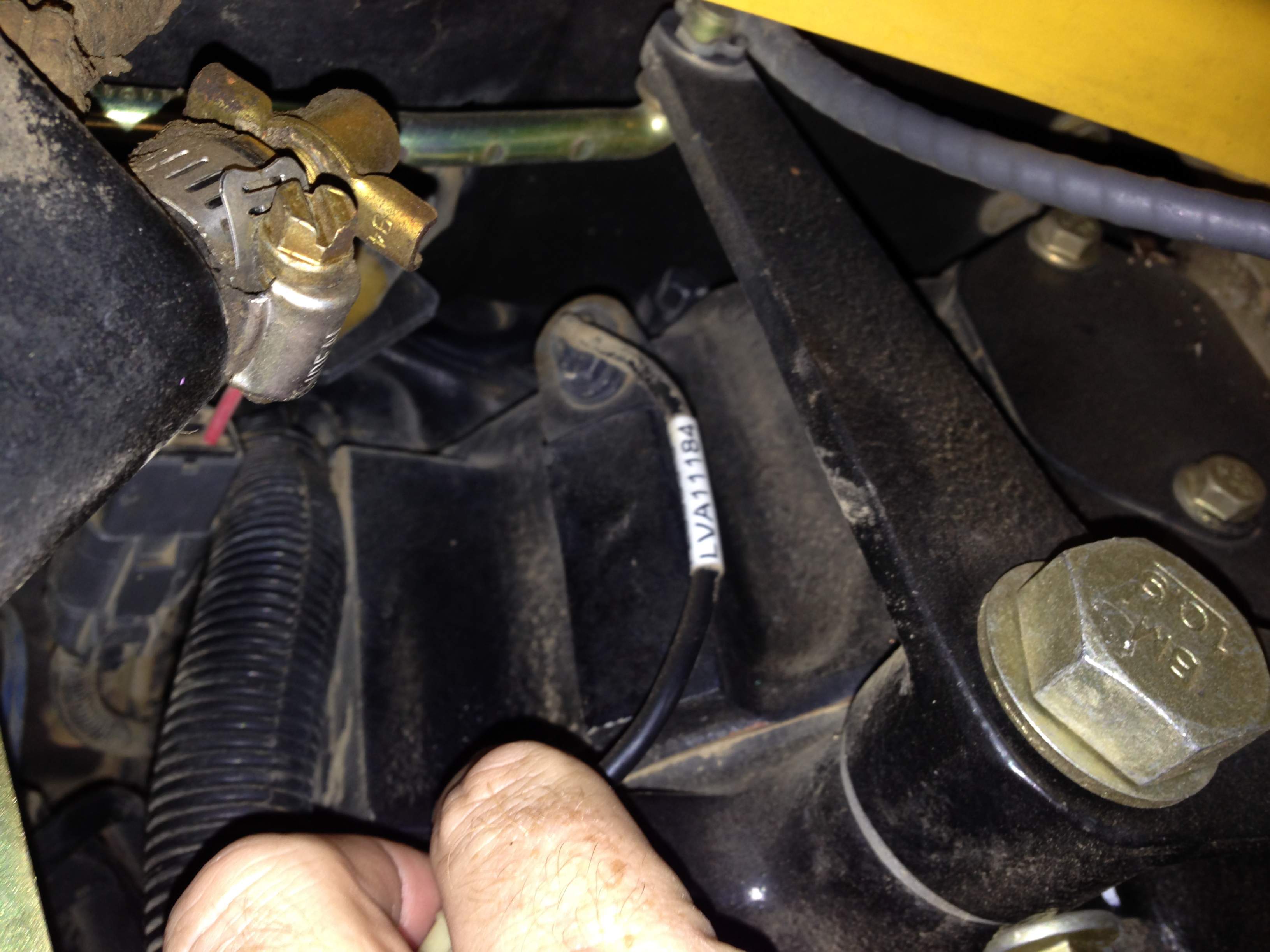

Here's a few pic of the flywheel sensor location.

Hello all, I have a 2007' JD 110 TLB. its surging only in forward. Ive read on here that its possibly the flywheel speed sensor. I purchased one locally from a JD dealership. Ill be damned if I can find its location. Im not real mechanical. I bought just over a year ago to do a project and it ran and worked awesome. Well recently, I went to move it in my shop and it surged forward after i let off the pedal. I drove it out of my building and it keeps happening. Reverse is fine! I really dont need the machine anymore..... Im ready to sell it. I guess my question is , do I sell it as is or take it in for repair before I sell it. It has like 2300 hours on it. Thanks, Dan

Maybe someone can fill you in with some helpful info on location.. What is the part # of the speed sensor you purchased?
Can backfeed that part # into the JD parts and possibly see where it goes.
   / John Deere 110 loader backhoe surging in fwd and reverse #37
its a Honeywell part # TA115587 sensor...

Sitting in the cab it is about floor level in front of your right foot.
Flywheel is behind the engine and the sensor has but a single wire...
Not where the tractor is at the moment or I would take a picture...
Best $50 I ever spent... hoping it's the same for you...
