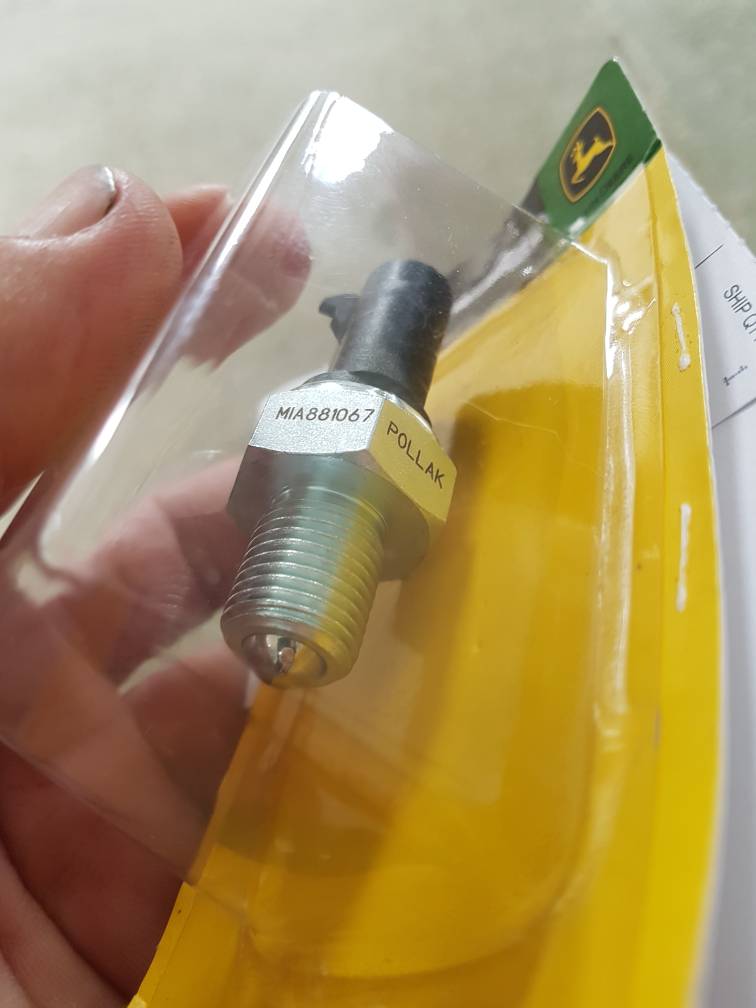

My customer has a 1026R with this same issue.
I am replacing the ball switch (#MIA881067).
The MIA881067 superceded to RE12411 on the 1025R which is more common down here. The parts are common between 1025R & 1026R so, since the MIA881067 was available off the shelf and the RE12411 was a delayed shipment from USA and twice the price, I chose to go with the MIA881067 switch.
The new switch was different to the old one in that it has the makers name & JD part no. etched onto the hex flats.
I don't know how the RE12411 differs but if you can get that one I'd say go for it.
There is no adjustment on an MIA881067. It's a ball switch.
Unclip wiring connector.
Unscrew old switch. Stick thumb in hole to stop oil loss.
Remove thumb... Screw-in new switch.
Clip-on the wiring plug.
You need a new o-ring #R26448 as well.
