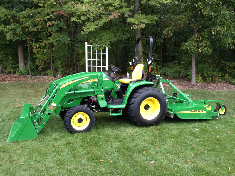

Like you, I started off looking at the 1026r. Seemed like a really nice tractor but I wanted something a little bigger. It came down to the 2520 and the 3320. I read everything I could about both tractors and still couldn't decide. I then found a dealer that had both tractors in his yard available to test drive. Within 5 minutes of driving, I was sold on the 3320.... My buddy tried to get me into a Kubota... After those orange tractors sit out in the sun awhile, they fade and turn pink :)
Here is mine....
that is a very nice deere, does yours have the hydro tranny if you don't mind me asking how much was your set up with front loader. John deeres website annoys me it is so hard to try and price everything out. I would love to own a deere but I can't get the price to match the equal equipment on a kubota. And if my tractor turns pink I am man enough to deal with it…lol
I checked my paperwork and the tractor was 21,246 and the loader (300 CX) was 4,910. It is a hydro with R-4's. I also got the mid PTO, rear Power Beyond and front plumbing to run a grapple. I'm having a great time with it. Hope that helps!
