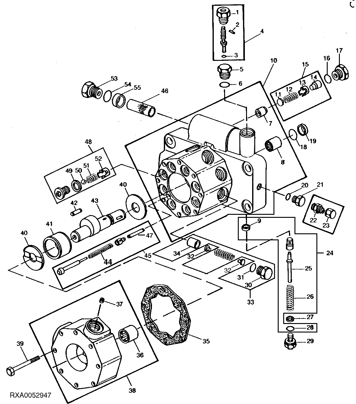

There is no relief valve on the closed center pump. There is a stroke control valve that de-strokes the pump when system pressure reaches 2250psi.

Oil pressure is low either because of a high pressure side leak or low flow from the trans pump to supply the front pump. Or the stroke control valve spring is weak and/or the valve/seat is worn. Dial the standby pressure up to 2300psi.

I will check the PS and rocker this week. I am going to hook up a gauge to the line and see what it is doing. I do not know where the adjustment for the standby pressure is. I plan on trying to find a service manual to look at this week.

HAVE YOU CHECKED/CLEANED SUMP SCREEN??????????? You keep answering you've changed hyd filter but a clean sump screen is just as important to the operation of this tractors hyd system as the hyd filter. Is your tractors serial number within or """above""" this range(010001-045199)?? The SN is on RH side of trans case under the seat. Have you tried tightening stroke control valve to increase stand-by pressure to the factory setting of 2250 psi?
