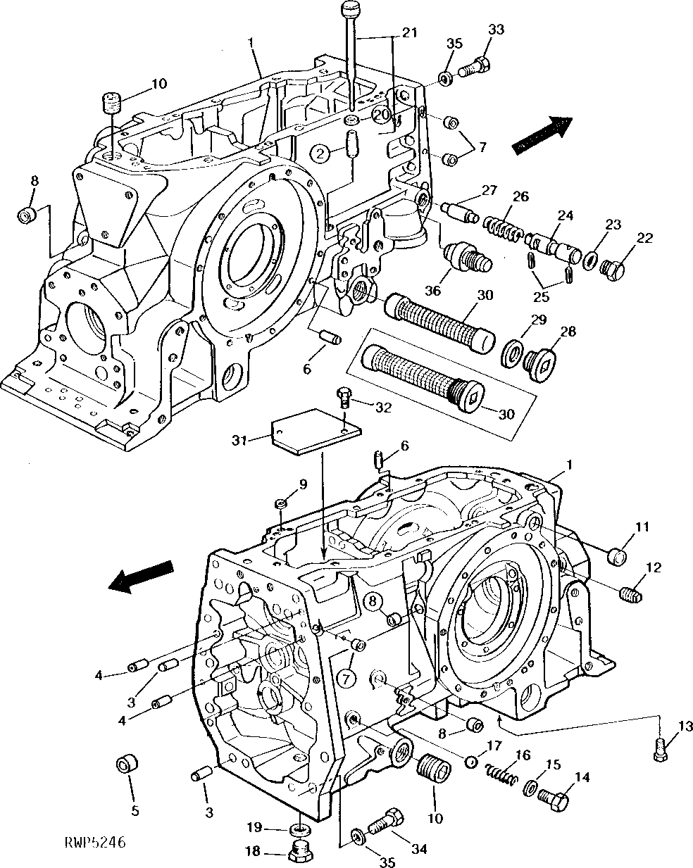

Trying to check trans pump pressure on a 1020 can be difficult at best. If tractor has SCV stand-by pressure can be checked there by simply plugging gauge in to breakaway coupler and activating lever. How long since hyd filer was changed and sump screen(parts key #30) checked/cleaned??? hyd filter relief valve b&d mentioned is parts keys #24 & #27
Thanks for the reply. This has been an ongoing problem. changing the filter and checking the valve did not help. It has JD fluid in it. With no use of hydraulics it has 1800 lbs pressure. Drops to nothing when you open a valve or under 500. If not a valve problem I think it is the pump (primary?) inside the tractor. I have a gauge by my controls.

Have you cleaned sump screen(parts key #30)?
