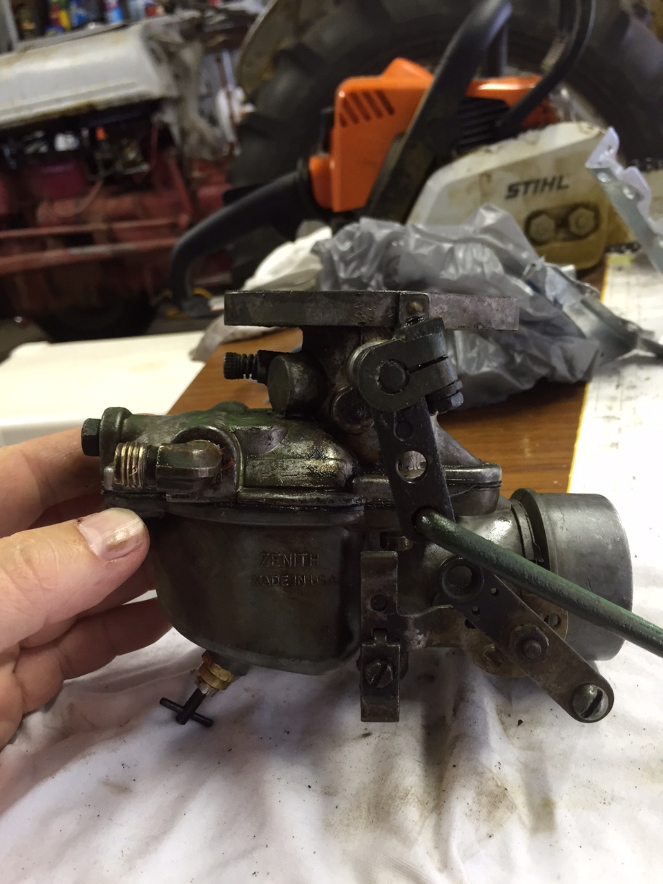

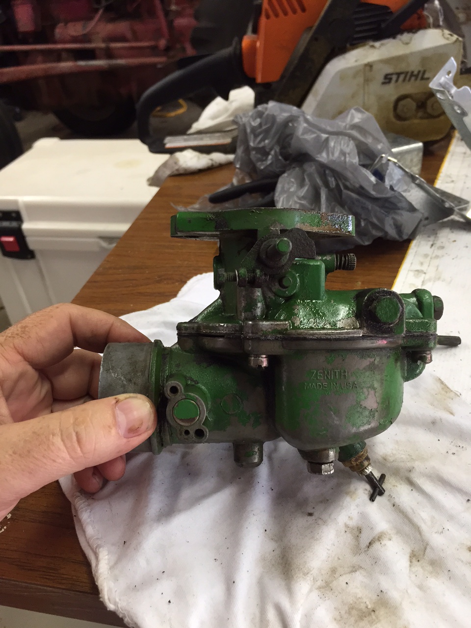

First Post, I have a 1020 yellow utility model John Deere. I need a new carb. The carb that's on it doesn't have any visible numbers for me to be confident in ordering the correct one to replace it.
I will try to attach some pictures. If anyone can help, it will be greatly appreciated.
carb2.JPG[ATTAcarb3.JPGCH=CONFIG]440056[/ATTACH]
   / John Deere 1020 unknown Carb. Please help #2
You need a Zenith replacement carb for a John Deere 1020 gas tractor.
Anyone that sells replacement carbs ought to be able to run with that info.
If they can't, find another seller.
   / John Deere 1020 unknown Carb. Please help #3
Why do you need a new carb? Most carbs are adjustable and/or repairable.
Found it,, tiny markings on the top. 14966..... The old carb was shoot, the bushings for the main butterfly were worn.. Bad part is ,, I didnt not fix my issue. It still start fine and idle fine, it revs up and after about 30 seconds dies from what appears to be lack of fuel..
Thoughts?
