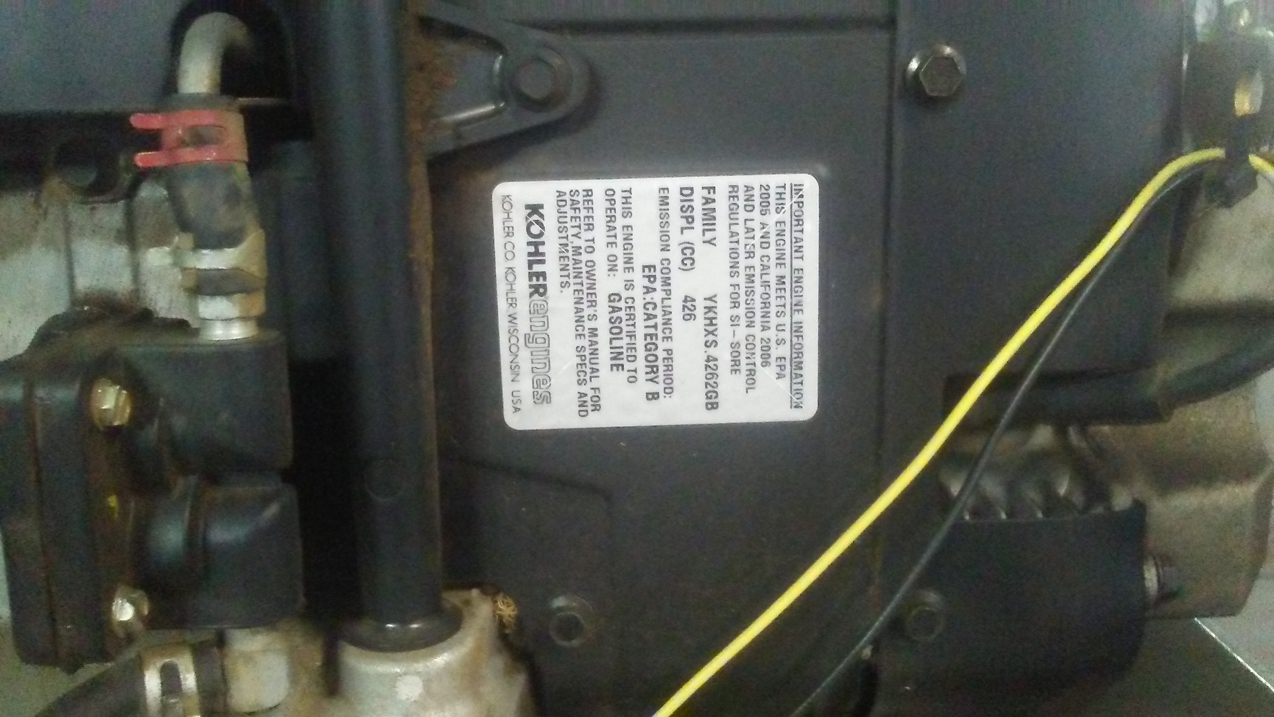

Not sure what I got then. The hood that is just sitting on the mower says LT 155. Here is a picture of the engine. Maybe someone can chime in and let me know exactly what I got. Thanks engine.jpg
/ John Deer Lt 155 #4
The tractor's serial number plate would be more helpful as that B&S would be used in a few different models
That Tractordata link will show where the plate is.

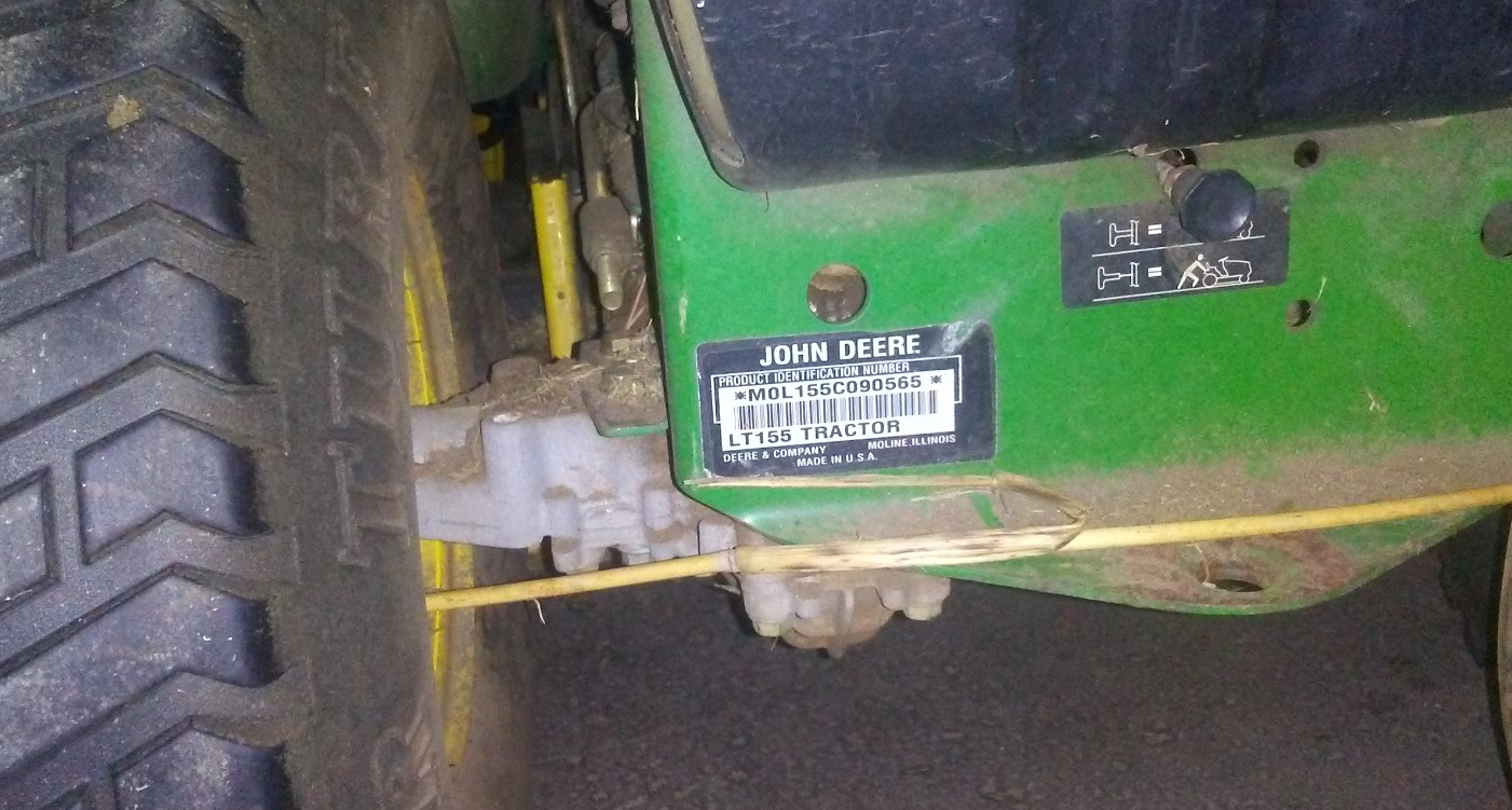

I took a picture today from mower, not engine. Here is the info .
Steering seems fine.
Blades are rough. Not sure this mower was taken care of but it still looks ok. Oil is nice and clean.
Looks like someone has been cutting big rocks instead of grass :) Blades are no big deal. I drove it today and it runs great. Just sounds like the blades are hitting something when I engaged them. Do these blades have to be timed like I read on the older models ? I know it sounds like they are hitting one another when I engage them. Have not lifted it up yet to take a look.

I ran the serial number and it appears to have been sold new in March 2001 in Alexander City AL. Since engine appears newer, it must have been replaced at some point. The LT series were the entry level lawn tractors at that time, but they were tough little machines. The mower blades are timed. It has a toothed belt similar to a timing belt on an engine. Belt may be bad or someone had it off and didn't time it properly when they put it back together. If it had a good hood and is in nice shape, it might be worth $400 but with a broken hood and deck issues $200 would be a decent price in my opinion.
