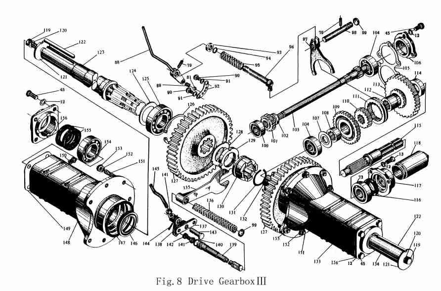

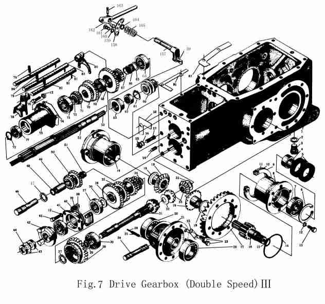

But since you persist in this notion, how about pointing out to us the dog clutches in the attached Jinma tractor drive train diagrams. Then perhaps you'd enlighten us as to how no damage could possibly occur to some of those slab-sided straight-cut sliding-rail gear teeth if/when are forced to engage under revolution and pressure .
I respectfully submit that as this type tractor drive train ages it actually becomes easier to shift gears - on the fly or normally - because of the fact that doing so since new has rounded the edges of the gear faces - thereby making it easier to mesh under rotation than when they were new.
//greg//

Thanks for helping to straighten me out Greg! Though I didn't get much more from your diagram than the fact that there definately are no dog clutches, my neighbor happened to have an old 8N manual which had a really nice cutaway shaded drawing that showed clearly how the straight cut gears have to slide into each other. So, I very happily learned something: a tractor transmission is nothing like a highway transmission. And, I can sure see how experimenting with trying to change gears while moving could do real damage. I noticed the 8N manual showed pretty big chamfers on the gear corners to help getting it into gear. Kindof amazing to me that a guy could ever change gears while moving ... almost seems like it would be a trick while stopped.
Thanks for the help, cheers!

The JInma 200 and 300 series and the KAMA TS series tractors have sliding gear non synchro tranmissions. When you shift these you are sliding gear sets into and out of mesh, when you hear gringind, it is the same teeth that must also drive the tractor. I do not recommend shifting on the move on this type. the KAMA KM454 and KM554 have constant mesh, non synchro transmissions The actual driving and driven gear sets are all in mesh (not reverse) and you slide dog clutchs that engage a pair of gears or another on the shafts. These can be shifted. If you hear "gears ginding" it is the teeth on the dog type clutches and not the driving teeth. of course damage to these teeth will also render the transmission inoperable as the gears will still turn but not the shaft. as has been said, synchro rings were added to help people shift at the wrong times and the wrong rpms and make it much easier to downshift. I am not aware of any common Chinese tractor with sychro but I have not checked them all.
