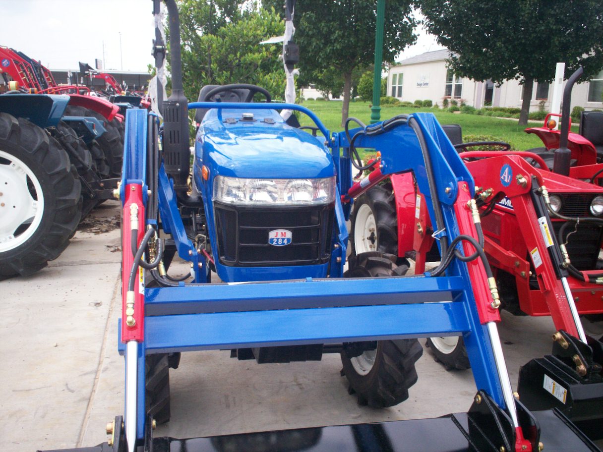

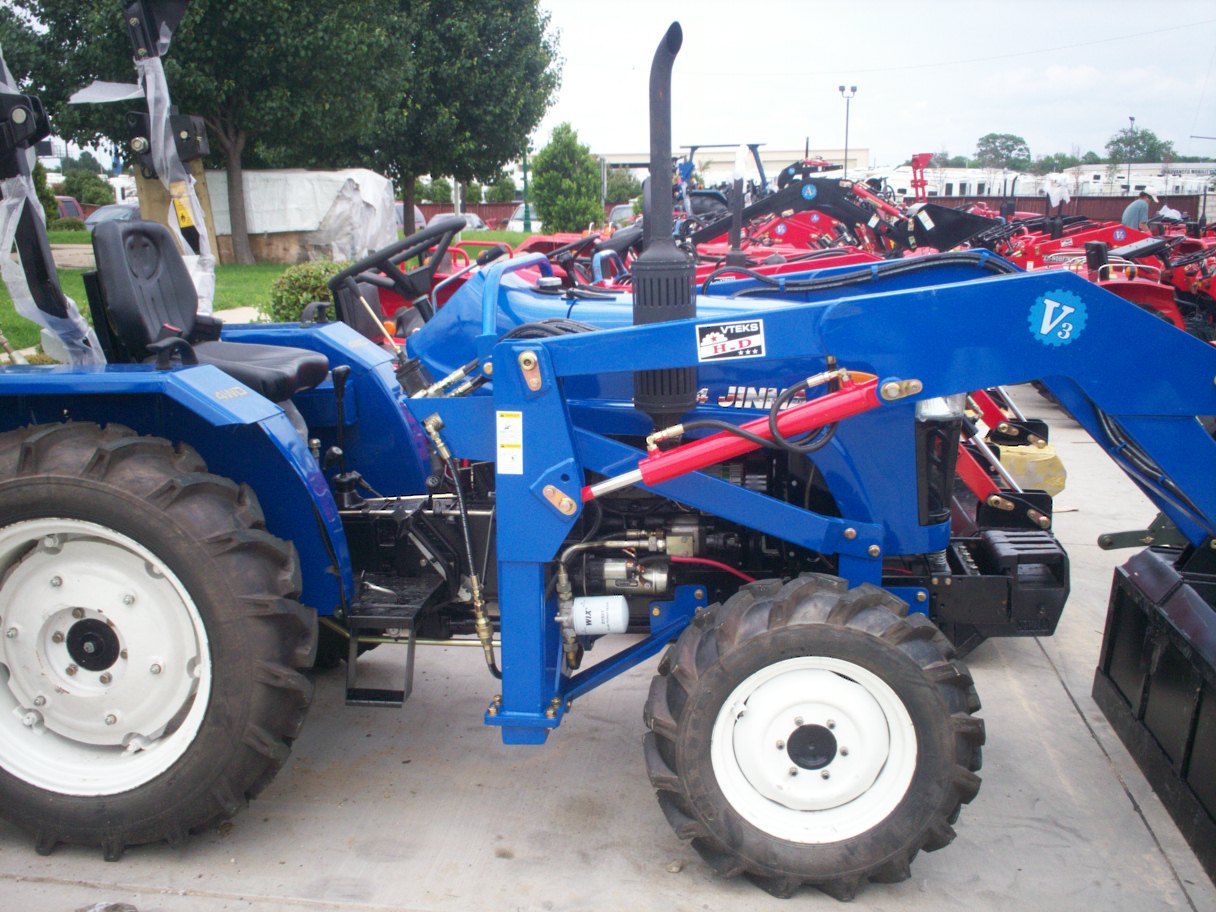

Any pics of your unit? Does it look similar to this, about the same size, is yours 4x4?

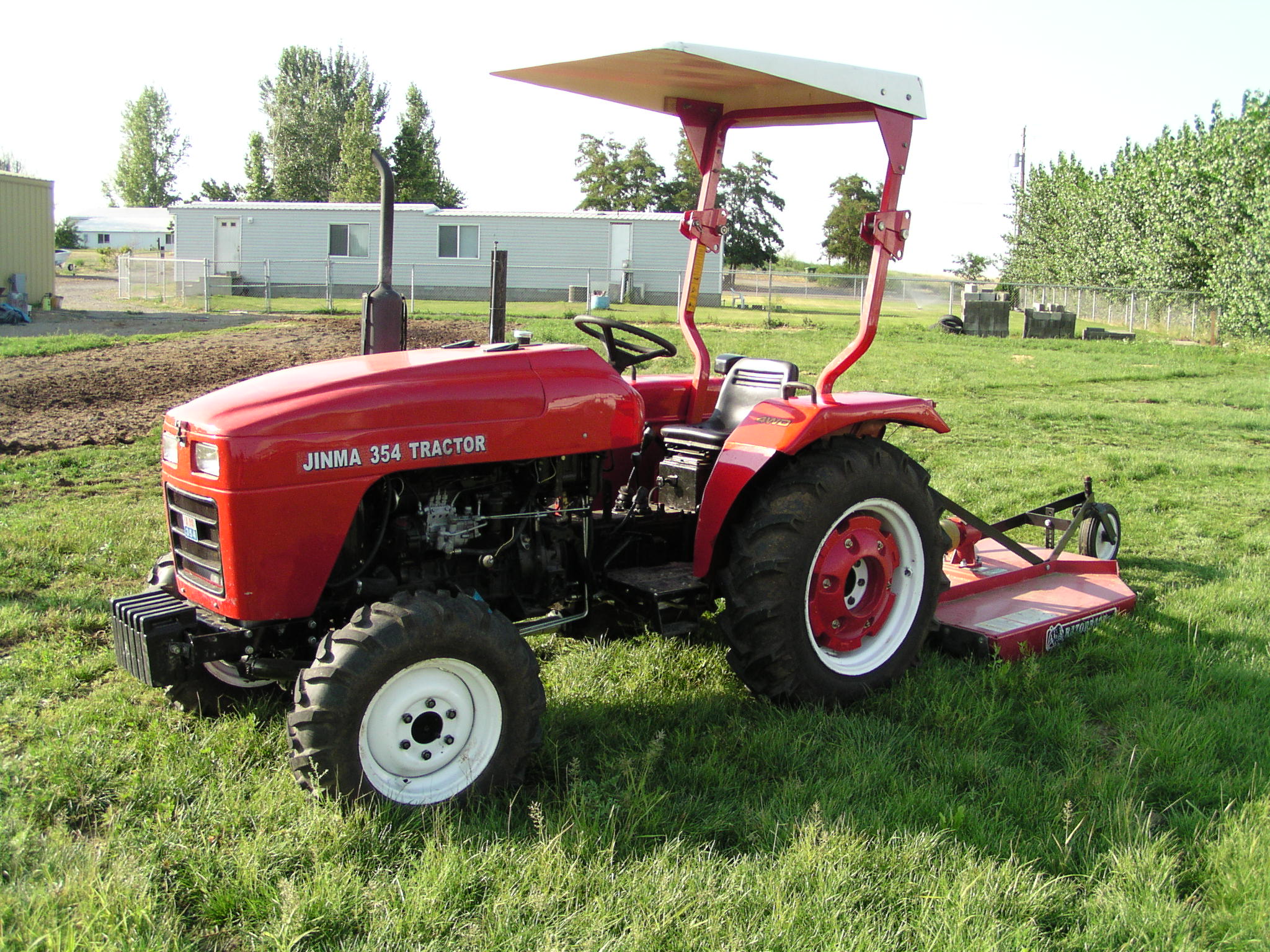

My Tractor is a JM354. The 300 series Jinma. I have no frontend loader. Just plane basic tractor. The picture you show is a 284, the 200 series. I feel a major difference in the tractors as build and weight and power. bjr
