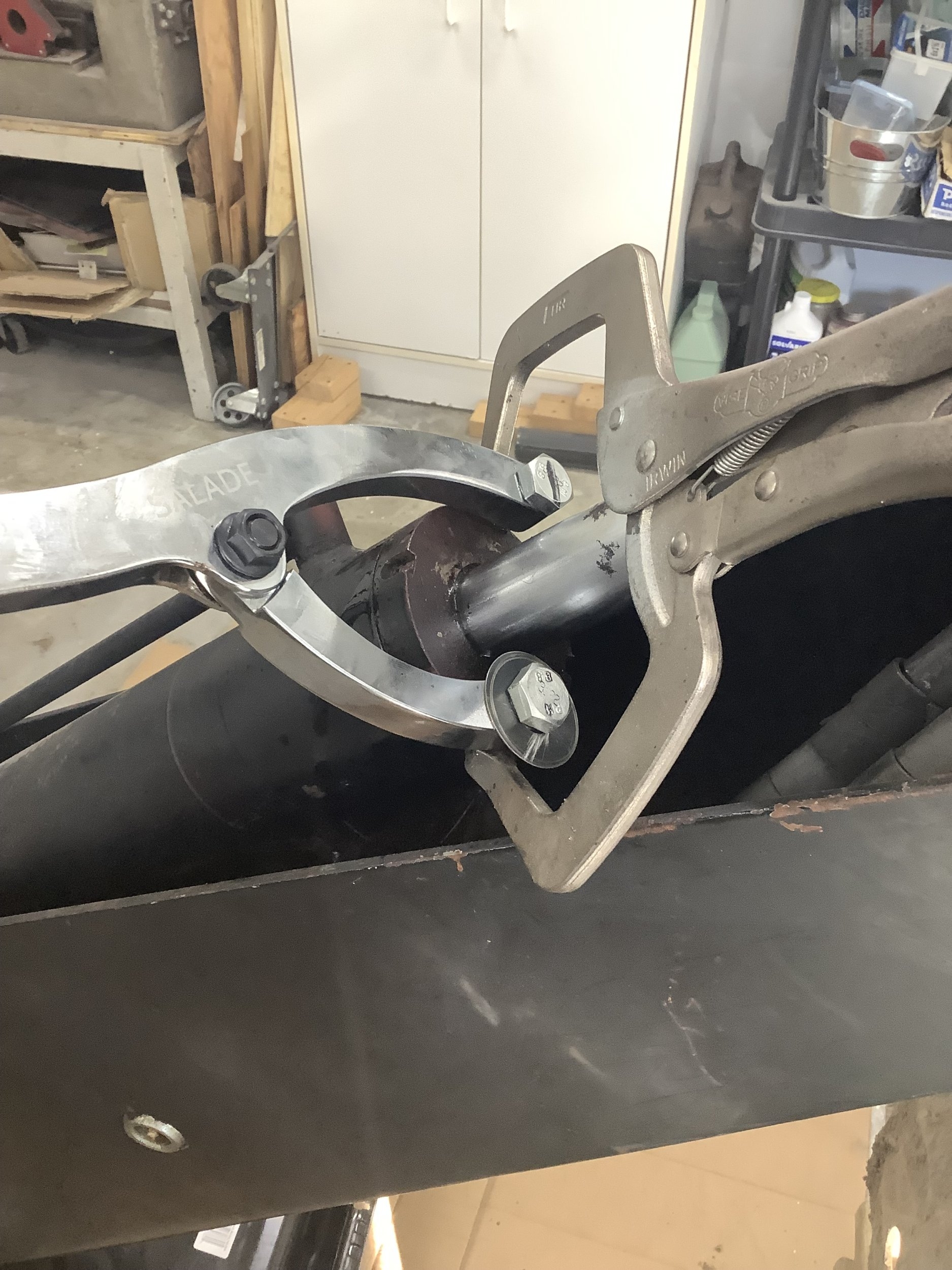

I’ve been trying to remove the gland nut off my 2005 Jinma 354 backhoe which is a LW8. Haven’t had much success yet so I’m hoping someone can point me in the right direction. I did buy a gland nut wrench but the inserts are for a pin type and I wasn’t able to find a Jinma style one. I did modify two bolts to fit the Jinma openings and also used a large welding vice grip to keep the modified nuts in place. Added a 4’ bar to increase the force but no joy.
I have a number of similar nuts to remove for the seal replacements on the backhoe so need to get this done.
Thanks for any help. Kind of a newby on hydraulics.

I used this for the gland caps on my skid steer. It worked well, but it will likely leave indentions on the cap.

Make sure there’s not a set screw in the seam that prevents it from backing off.

Watched the dealer use a 3 foot pipe wrench coupled with a 4 foot pipe to remove the nut on my Kioti; definitely left some marks

The hydraulic shop I worked at had the 4’ pipe wrenches and cheater pipes. Numerous times we would be heating the cylinder around the nut while two put their weight on the pipe.
I was told that the bigger shops had an impact device to remove them but I never saw one.

I’ll check for a set screw but don’t think there’s one. Next is heat with force. Maybe I can make a better gland nut wrench via pipe and some welding.

It’s not an impact. It’s basically a heavy duty pipe vice with a pipe wrench that a hydraulic cylinder pushes.

Once you’re confident there’s no locking screw then a longer cheater pipe is probably the answer. You could try having an assistant hammer against that notch with a chisel while you turn the wrench.
