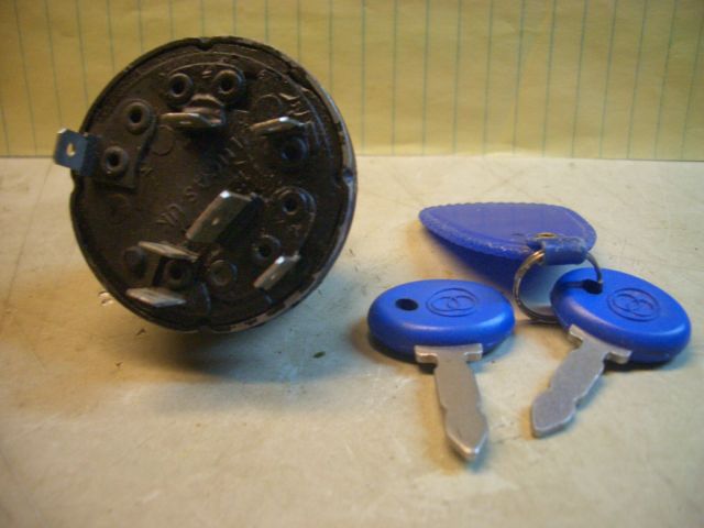

The switch that i mentioned is the right switch. It is a five position switch. It is identical to the switches mentioned and shown in various other threads on this site. It is a 5 position switch, the two farthest spots to the right are both momentary, one for glow plugs and one for start. I just looked at TSC's site and can't find it on there. I will take a picture of it and post it with a part number tomorrow morning.

OK, sorry it wasn't this morning, but the TSC part number is 2301088

/ Jinma FYI #16
that key switch look exactly like the ford cold start i bought at my local auto parts store but i was thinking it was less than 10 bucks
/ Jinma FYI #17
Yup. That's a Chinese aftermarket copy of the Ford/Lucas switch. They typically run in the $10-$13 range. Significantly inferior to an actual Ford or Lucas switch, but much more available - and a helluva lot cheaper. Real Ford and Lucas switches are in the $65-$70 price range (new), but likely live longer than most Jinmas. That said, and despite the low price, the farm/auto store and eBay Chinese clones will still outlast the OE Jinma keyswitch.
