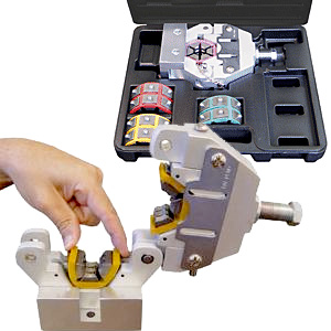

Has anyone used a crimper like the one in the picture to crimp a hydraulic hose for an attachment on a tractor. 2500 psi hose.
Just had a hose end blow off @ around 2500 psi. Lost 4+ gallons of fluid in about 10 seconds. Local hardware store crimped it. Took it to a real hydraulic shop and they said it was crimped incorrectly. It was quite exciting. Now I pay attention to where a hose is going to go if it comes loose!
