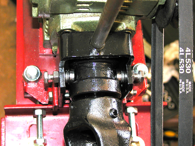

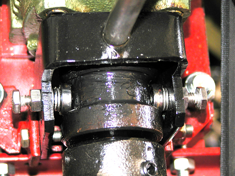

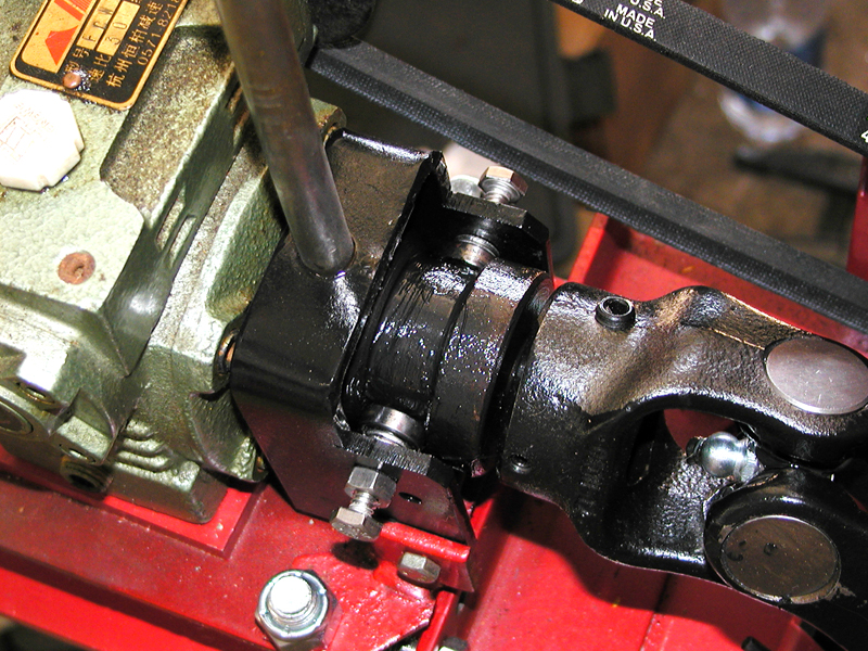

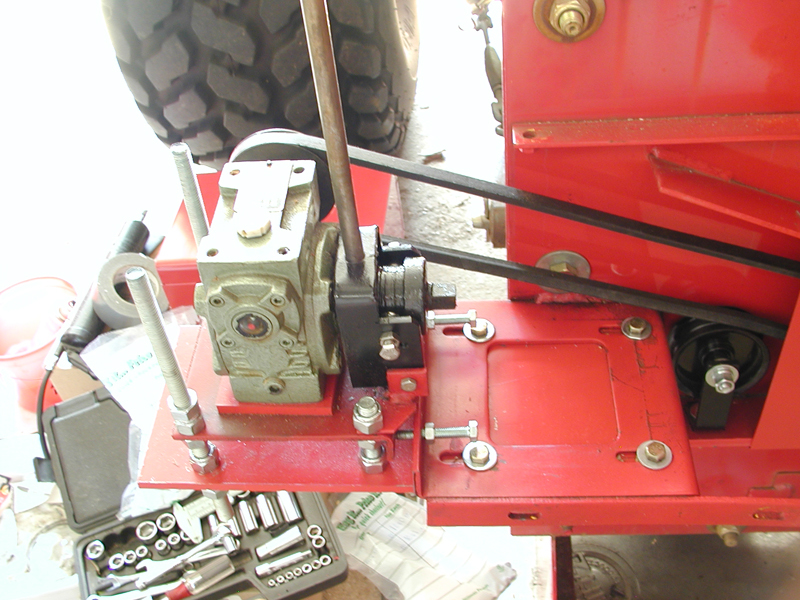

These photos show the bracket that I made to hold the roller bearings for the disengagement cluth. The bracket was not absolutely necessary but I wanted a positive stop (against the gear reduction unit) on the back and better clearance in the front (to clear the old cover). The nuts, bolts and spacers used with the roller bearings are stainless steel. I decided to replace the short bolts that secure the attachment plate with longer threaded rod to prevent little hands from reaching the v-belt and drive shaft. I may make an endpiece later (not likely) and longer bolts may come in handy. Some photos show the roller bearings in the clutch close up.

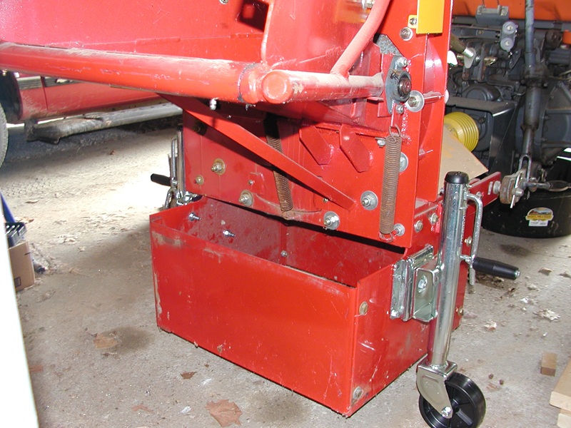

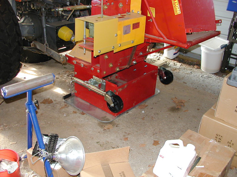

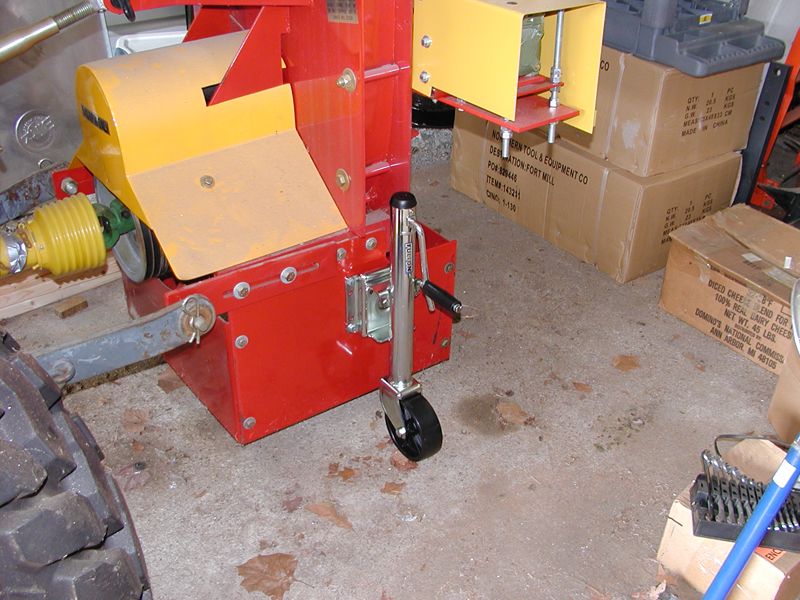

It wasn't much of a problem carrying around 4x4's and 2x4's to level my pto shaft whenever I set the chipper down to chip. However, I figured there must be an easier and faster way to do this. Since I had a couple of trailer swivel jacks not being used, I decided to see if they could speed the process by mounting them on the chipper. I did some measuring and then drilled holes on each side of the chipper at what I determined to be the best balance point. It took about 15 minutes to drill 4 holes on each side. It took another couple of minutes to adjust the jacks so that when the chipper is lowered the jacks would keep the pto shaft level. Now, whenever I want to run the chipper, I just pull the swivel pin and snap the jacks vertically and then set it down. Very seldom do I ever have to re-adjust the jacks for level. I replace the wheels with a set of pads if the ground is too soft. I like using the wheels because when the ground is hard I can drive short distances from one pile of trees to the next without lifting the chipper. I may swap out the current wheels for ones with bearings so I can pull it longer distances without being concerned about the wear (the current wheels are well greased but consist only of a shaft and steel bushing). The jacks are rated 1,500 lbs each (according to the side plate) so they should be able to handle it (notwithstanding a hidden stump or large rock, etc.). :) To store the chipper I simply rotate the jacks to their horizontal position and lock them. They are then out of the way. This 20 minute modification was well worth the trouble. As best I can remember the jacks cost about $10 each from surplus. I have attached 3 photos taken right after installation. They show how the jacks were mounted to the right and left sides, how they look set vertically and how they look set horizontally for storage.

Had you mounted them further back, and added one to the front, you could have rolled it around your garage to store it when not in use.
I have been trying to keep up with peoples mods to the Jinma chippers, and have yet to see anyone modify the chute to rotate. Seems to me it would be a good mod, so one wouldn't have to move the whole tractor as the pile of chips grows. Anyone done it??
   / Jinma (Farm Pro) chipper mods #20
Terryo, good idea! Thanks for sharing.
