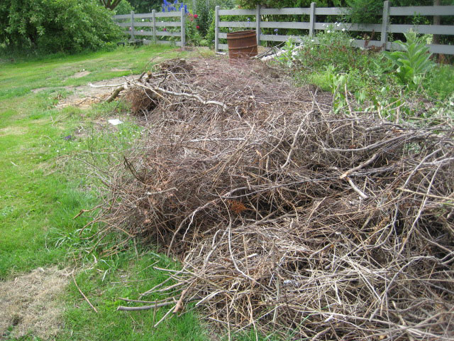

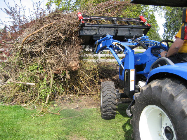

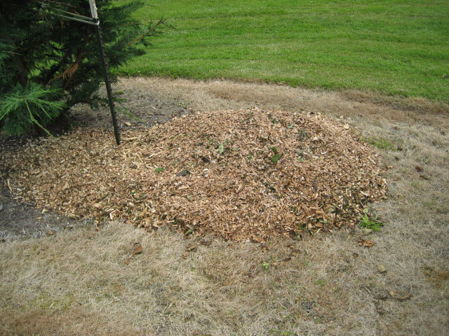

Okay Jack, here are the promised pics:
Building the brush pile with my Bull Grapple.
Brush pile partially reduced.

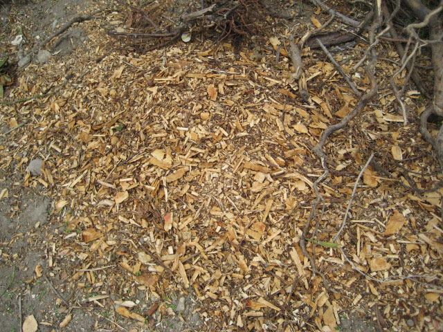

Size of chips when knive to anvil distance was about 1/4".
Size of chips when knive were set 0.02" (book says 0.01-0.03")
If possible, don't chip green wood (especially pine). A friend did that and had to basically take the chipper apart to clear the needles that had really gummed up his chipper. I had an old Christmas tree in that pile and the chipper sucked it up with no problem.
One other thing I've done is coated the knives, anvil and chute with "Fluid Film". That stuff works great at keeping the tree sap from sticking. Even with the Fluid Film applied, I would still recommend against chipping green wood. It just avoids a lot of gumming up the works, that's all.
