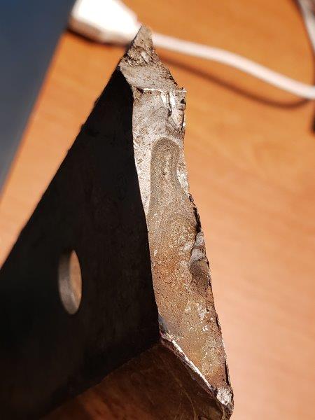

I've had my chipper for many years and am pretty familiar with all the usual repairs, knife replacement, feed roller problems, etc. Last year I replaced the knives and used factory fasteners, self locking nuts, torque wrench, etc. It ran fine all summer.
Last week I was chipping some small 2" pine windfall and it began to self destruct so I immediately shut it down. I'd been running it for around a half hour before this event.
One blade had completely fallen off and the other still had 1/4 of it attached. I've not yet gone into the bottom of the housing to see there are any whole screws or just failed screws. The anvil was 50% torn off along the length. One of the ribs in the back of the flywheel is missing a good sized chunk. Inspection of the main flywheel shaft showed no movement or looseness of the pillow blocks and no movement of the shaft itself. The clearance between the rear of the housing and the flywheel ribs was close and seemed consistent.
I read a lot of other posts about the flywheel and shaft moving but I don't think that's the case here because the debris and dirt around all the mounting points is not disturbed.
Before I decide what do with this I wonder if anyone has any theory?
The branch that I was chipping still had some snow on it and maybe there was a stone frozen in place but I cannot imagine a stone causing all this. I've had small stones in the past but they bounce around and I shut it down. This seemed to be a complete and instantaneous failure.

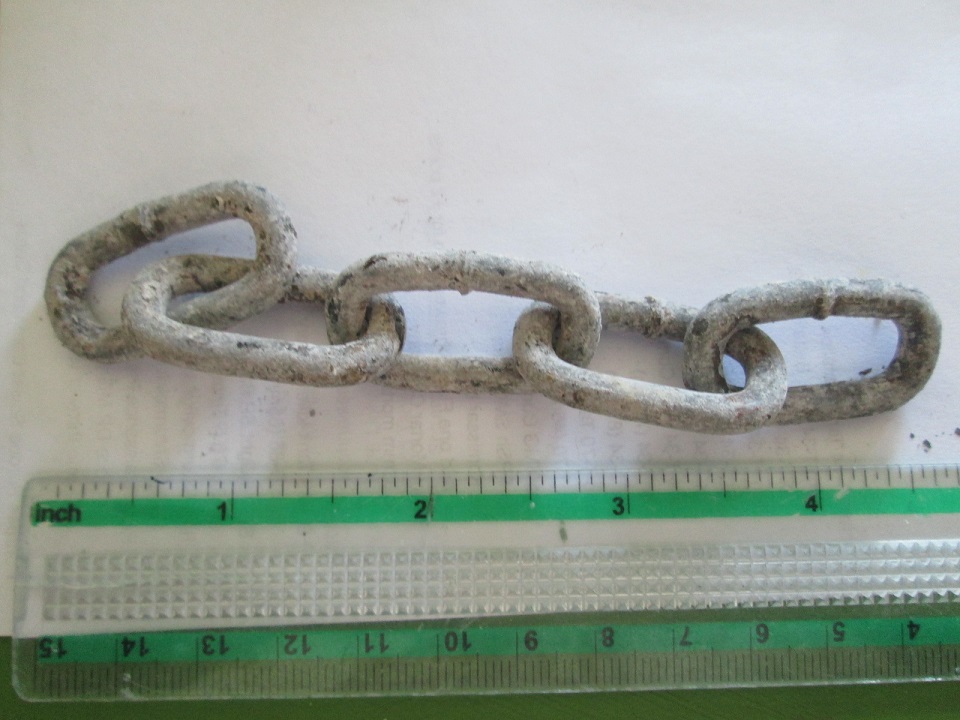

Checking the bottom of the housing will give a better idea what happened. Trees have habit of picking up drebris. Found this in the ash trayof my wood stove this winter. Firewood had been cut and split, never saw it.
/ Jinma Chipper Self Destruct #4
I got a pickup and trailer load of firewood from a dangerous tree removal arborist. Two short lengths of about 12" diameter tree were joined by a short chain like shown and 2 lag screws about 1/2 x 8"... I was able to split all of this apart on the splitter and even reuse the chain on another project.
Knock on wood, this all the hardware I have run into..... so far....

One of the exposed fracture surfaces shows corrosion while the balance is a fresh fracture. It suggests there was a pre-existing crack which was the root cause leading to failure. Once that piece let go, everything else failed.
I think the crack in the blade has been there for a while. I recall a rock bouncing around in it last year and maybe that's when a crack initiated. Fortunately I have stash of spare knives and anvils. When I bought two chippers and a backhoe I included all sorts of spare parts plus spare parts for the tractor itself. Unfortunately, I didn't plan on a spare flywheel!
