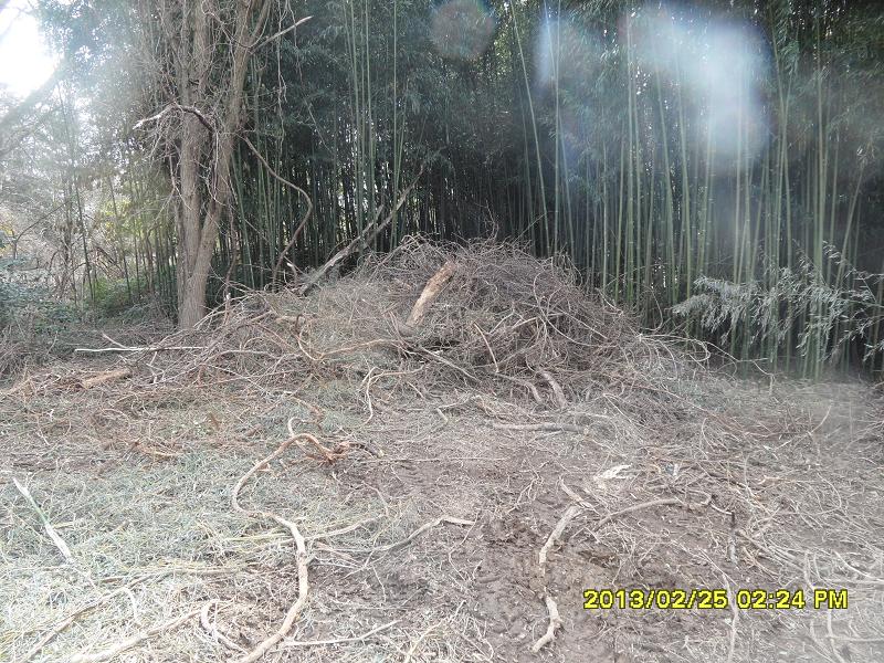

My planned long term usage is chipping trees I will have to clear for my deer plots and trails. My IMMEDIATE NEED is to take care of mounds of vines, brush, and trees.
Lot's of pieces 3" and bigger needed to be cut up.
These are pics of some that I and my son piled up while clearing a lot in northern Virginia. It was probably going to cost me $600 plus to rent a 6" chipper. And then have to use it regardless of weather.
http://www.tractorbynet.com/forums/attachments/276088-brush-removal-strategy.html
Not nice long branches, but twisted masses.
/edit - the twisted masses of vines were all cut in the winter and for the most part were getting dry

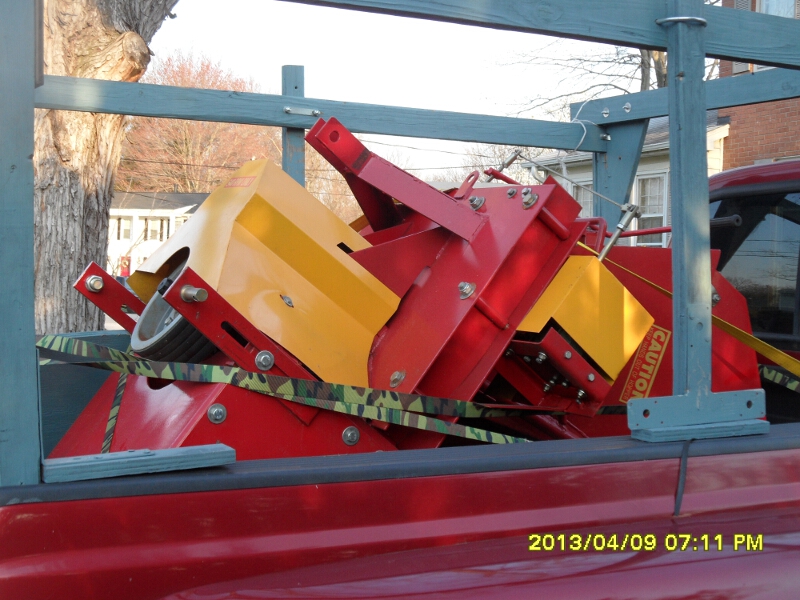

Pickup in North Carolina was a breeze. Ronald has a working buddy, Gene, who handles the putting it in the truck part. Another good guy. Gene pointed out special points (all of which are covered on Ronald's web site). Note it is a fairly big unit fully assembled.
I had to temporarily remove part of my homemade ladder rack (4 bolts) for him to slide it in. And later for me to slide it out.

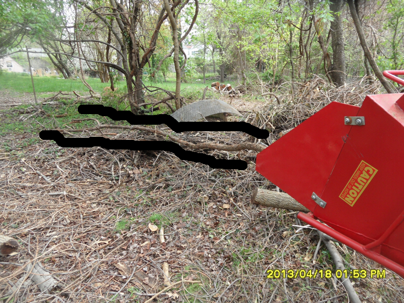

I had one vine about 25' long and started at about 2.5" in diameter (pic).
Made quite a pile. At one point I filled the hopper with medium vines and branches and just forced it all thru with a push stick. It just kept on chugging.
