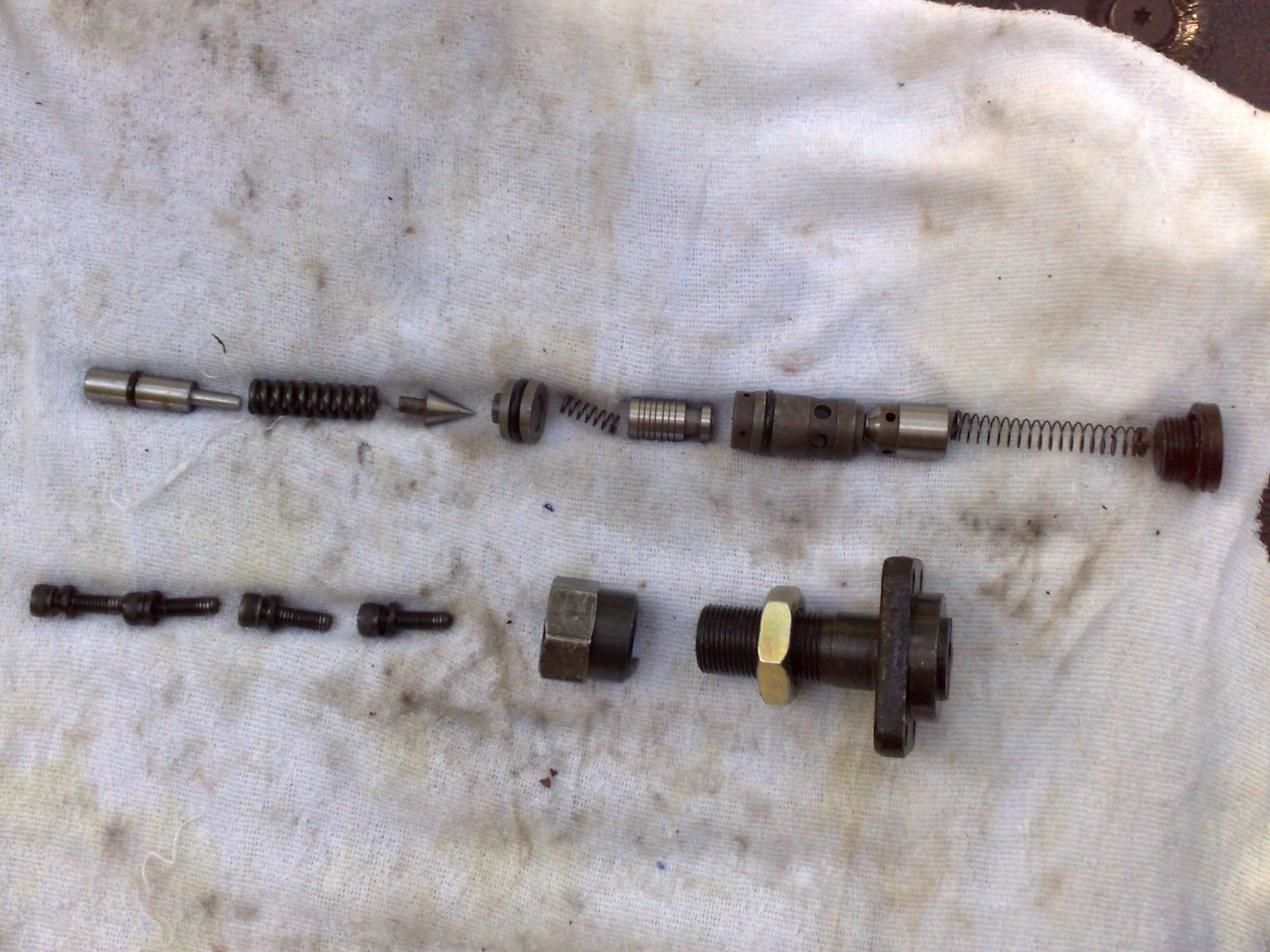

Problem was 2 busted O-ring on the center part of the relief valve
here some picture of the relief valve (parts are place in order)

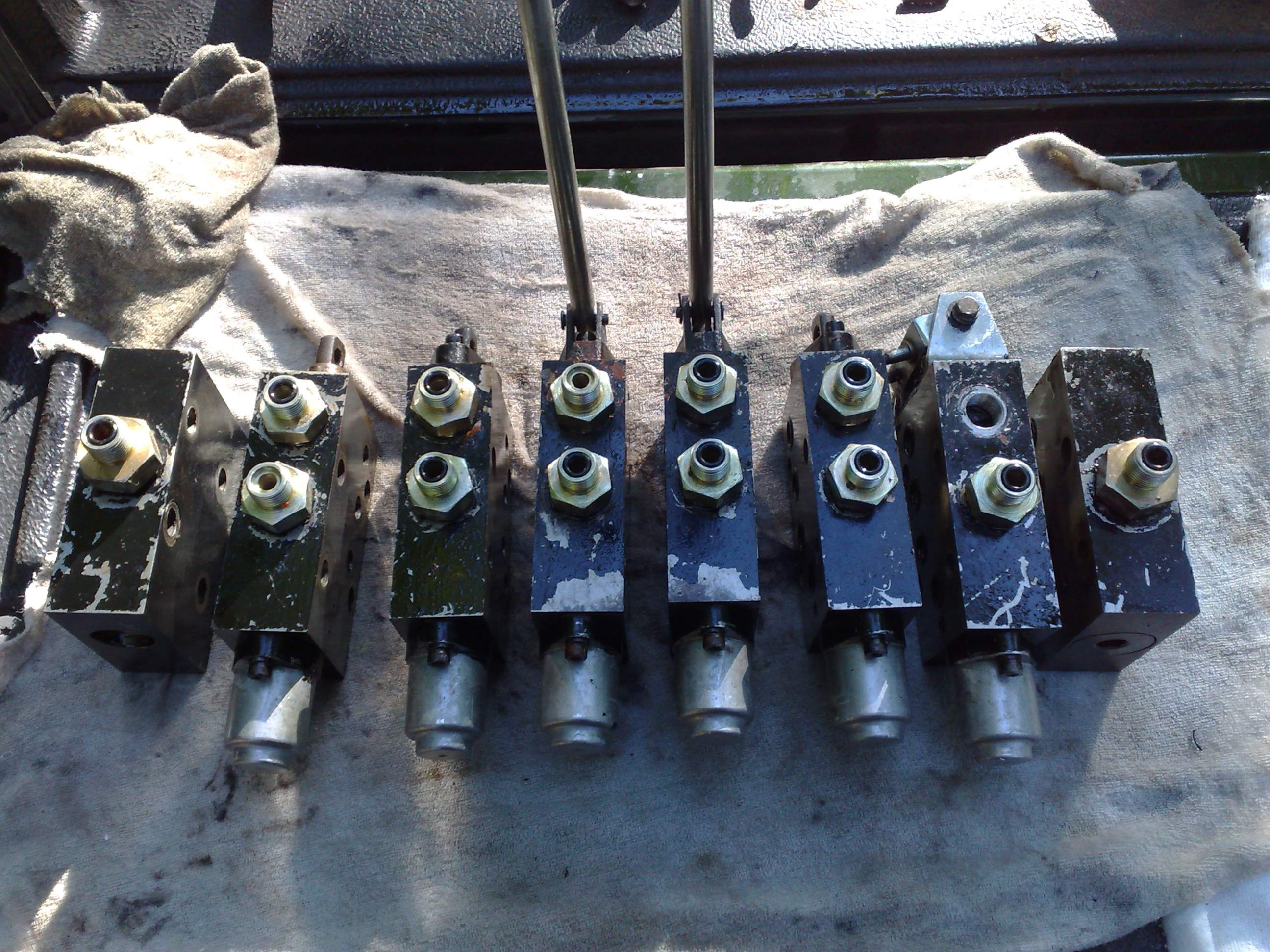

and some of the valve body

Thanks for the post and finding those busted "O" rings.

One question in that last photo, there was no hole in the red circle on the mating half. What was all that about? No hole needed there or is it missing?
the last piece is the relief valve body so it doesn't have all the hole they other have. but there is alot of O-Ring inside those pieces and in mind they had alot of black residue that needed cleaning, it was a good thing for me to do and i have learn how it work at the same time :cool:

PS the picture I am referring to is in post 10 left picture.
I know this is a old post but this is the exact problem I am having. I got the PRV apart except the upper piece which in the left picture is the #7 part on top row - it is the one the check valve seems to sit on which is 4th from right on top row. Question 1. is this channel straight all the way thru. I see a lip in there from the top but not sure if its cut in there or recessed in the part I am trying to remove. Have tried light taps but not sure how hard. And the lower Oring is broken - sure thats the problem but want to check the one up top also.

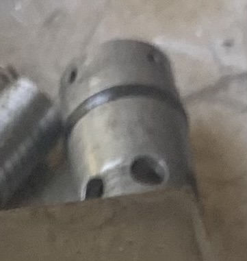

I got an Ginma 304 backhoe that I am cleaning and changing the O rings. I got all the other O-rings, but there is a piston that has a flat groove ( see attached picture) and I am not able to find the right O ring. I even contacted CircleGTractors for the parts and did not get a reply back. Any idea how to deal with this?
Get a o ring I’d app (Olypsys) to I’d the o ring size. Then order the right one and replace. It’ll be metric. Post your results with photos for us.
