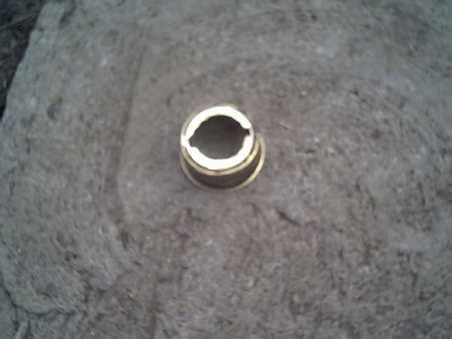

/ Jinma 304 Running Cool? #11
more pics
/ Jinma 304 Running Cool? #12
I just ground down the jinma thermostat to fit a new American
/ Jinma 304 Running Cool? #13
Thanks Alpha,
Just pulled my thermostat, though there was one in there it was rated at 57 deg C (about 150 deg F). No wonder it is running cool.
Will try your mods to adapt a US thermostat.
Hank /forums/images/graemlins/smile.gif
