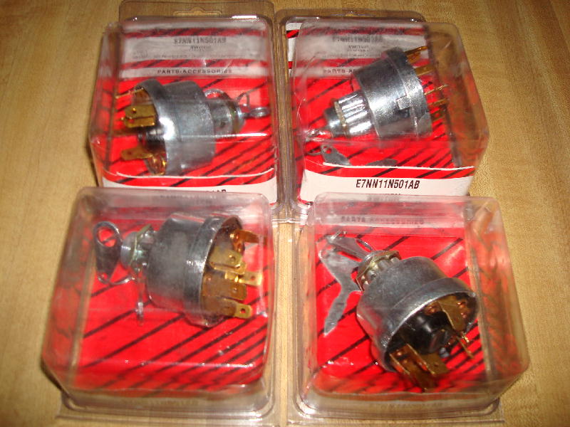

Have you ruled out the clutch safety switch? It wont turn over unless the clutch safety switch is closed. There could also be a corroded fuse that supplies power to the switch or starter solenoid circuit, might be worth removing and cleaning every fuse just to make sure that's not a problem. Attached is a pic of the "Ford" switch to supliment the info Greg supplied. Google search part# E7NN11N501AB to find a supplier. Nice of Greg to offer his spare switch. A bunch of us on another forum upgraded our switches along with installing Delco 12SI alternators. I bought all the swithces to send out to the members and have a few spares myself.
Larry

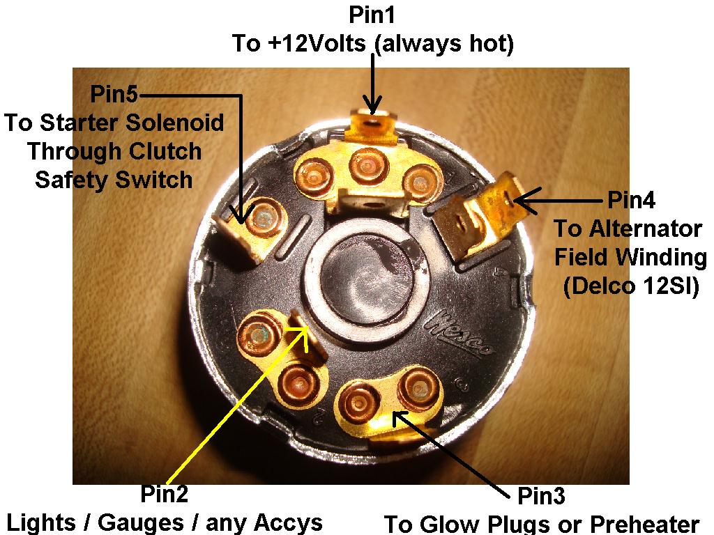

/ Jinma 284 ignition switch #4
Followup...
This is the best supplier with the lowest price and most reasonable shipping I could find...
CLICK HERE scroll down and find part # E7NN11N501AB
Pin / connection
1 / Off connect to hot (+12 )
2 / For tractor power (Lights, gauges) + any accy's.
3 / To glow plugs
4 / To alternator field winding (provided you upgraded to the Delco 12SI)
5 / Starter solenoid (through clutch safety switch)
Here are the contacts vs key position:
Key position starting all the way CCW
Key Position 0 - 4
0 - OFF (no connection) except +12 to pin 1 of the switch
1 - (1 click CW) Pin 1+2 (Tractor lights and gauges only)
2 - (2 clicks CW) Pin 1+2+4 (Delco Alternator 12SI field energize) + Tractor power, lights, gauges + any accys).
3 - (3 clicks CW Spring return back to 2) 1+3 (Glow Plugs only)
4 - (4 clicks CW Spring return back to 2) 1+3+5 (start+glow plugs)
Of particular note - this switch is one of few were glow plugs are hot at same time starter is engaged. The OEM switches do not do that so it's a definite advantage to have one of these switches installed (provided you have glow plugs).
