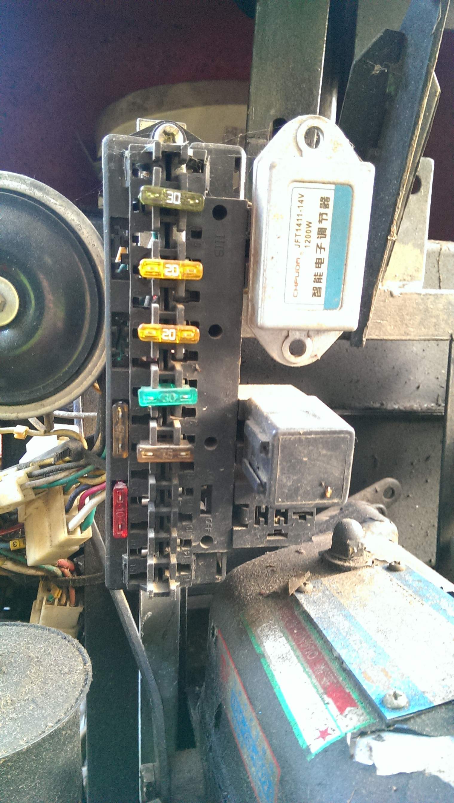

Hello again!
I have been trying to get some of the electrical things working again on my tractor and step #1 for me was to check all the fuses. Well, they all look good but when I started looking into the fuse box layout it appears the guy before me may have screwed up some of the fuses. Does anyone happen to know exactly what the layout is supposed to be? According to the only pictures I can find online it looks like not only am I missing fuses but also may have some in the wrong place!
The tractor has been starting fine (until yesterday at least), electrical panel seems to work OK and the headlights even come on. Electrically the only things that didn't seem to be working are the rear work light and the flashers.
I went to start the tractor yesterday, turned the key and the panel turned on fine. I turn the key to the start position and absolutely nothing happens, starter doesn't even tick. I would like to get my fuse box straightened out before digging in much further, including replacing ALL the fuses to be sure they are all good. After the fuses are good I plan on trying to use the screwdriver trick to try to start the tractor to see if I can narrow down where to continue looking.
Here is a picture of what my panel looks like currently, which is exactly as it was when I got it (used).
Thanks in advance!

Here are some pictures and drawings of my Jinma 284 – perhaps they will help.
Here is the fuse box front:
Here are the fuse box wires:
Here is back of fuse box ‘flipped over’:
In case you need to get into the Connector:
Finally, here is a description of the wires/numbers on my tractor:
I am hoping that RonMar will see your post. He has an excellent schematic drawing of the Jinma wiring.

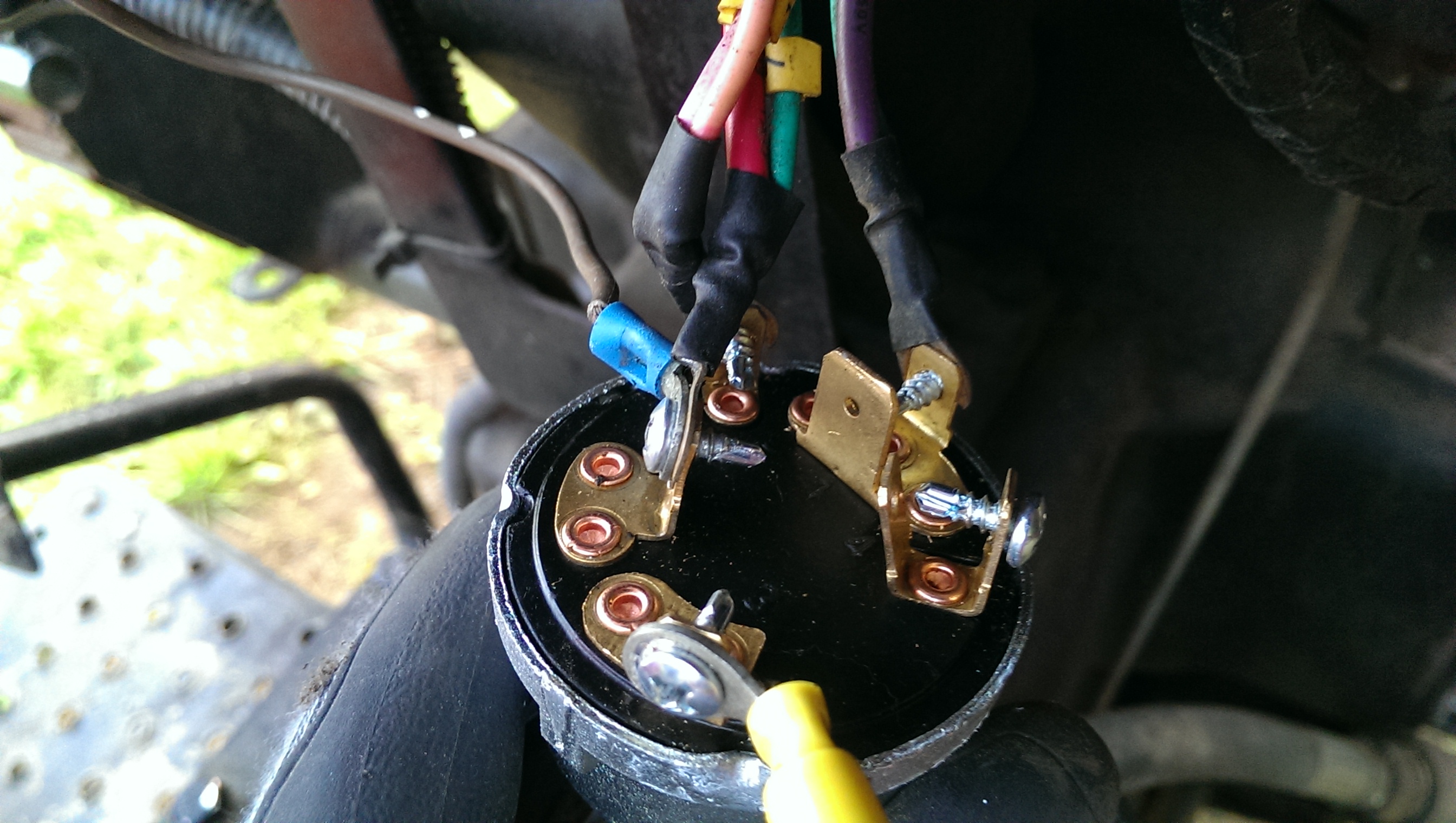

Hello again!
Wasn't sure whether to revive this thread or start a new one.
So things were working well for a few weeks but then the main 30A fuse started to blow whenever I tried to start the tractor. It starts to blow as soon as I turn the key to the pre-heat glow plug position, not even the starting position. What is interesting is that it blows the main plug with or without the fuse for the glow plug in the fuse box.
I found the switch for the Ford cheap enough online that I decided to just order one since the factory one is pretty beat up and I only had one key for it, figured it wouldn't hurt to try to switch that out before chasing down all the wires. So the new switch came today and I wired it up the same way the factory switch was wired which I THINK is how the diagrams I found in another thread have it listed. One mistake I initially made was attaching the wires to post 4 instead of post 5 and interestingly it started right up but it started on a key position that was not the spring loaded temporary position. It was a position that the key would stay in so it would stay cranking the starter motor until the switch it turned back to the left one position.
Once I saw that I noticed I used post 4 instead of 5 so I swapped the wires to post 5 and went to start it back up and sure enough the fuse blew immediately just like before! So I am assuming there is some wiring or something shorting out somewhere, any advice on where I might start looking? Everything else electrically seems to work as its supposed to, lights, flashers, work light, etc. Also, on all of the diagrams I see it lists only one wire going to each post but my tractor seems to have a couple of wires going to a few of the posts, not sure if that is normal or not?
I will try to get some pictures of it tomorrow morning if that helps.
Thanks again!

I replaced the switch on mine with a regular automotive ignition switch, an IH truck I believe and used a relay operated of a pushbutton for the glow plugs

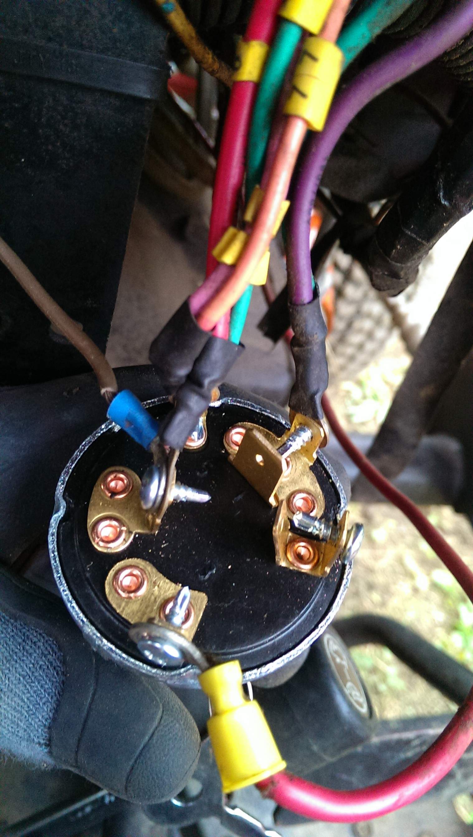

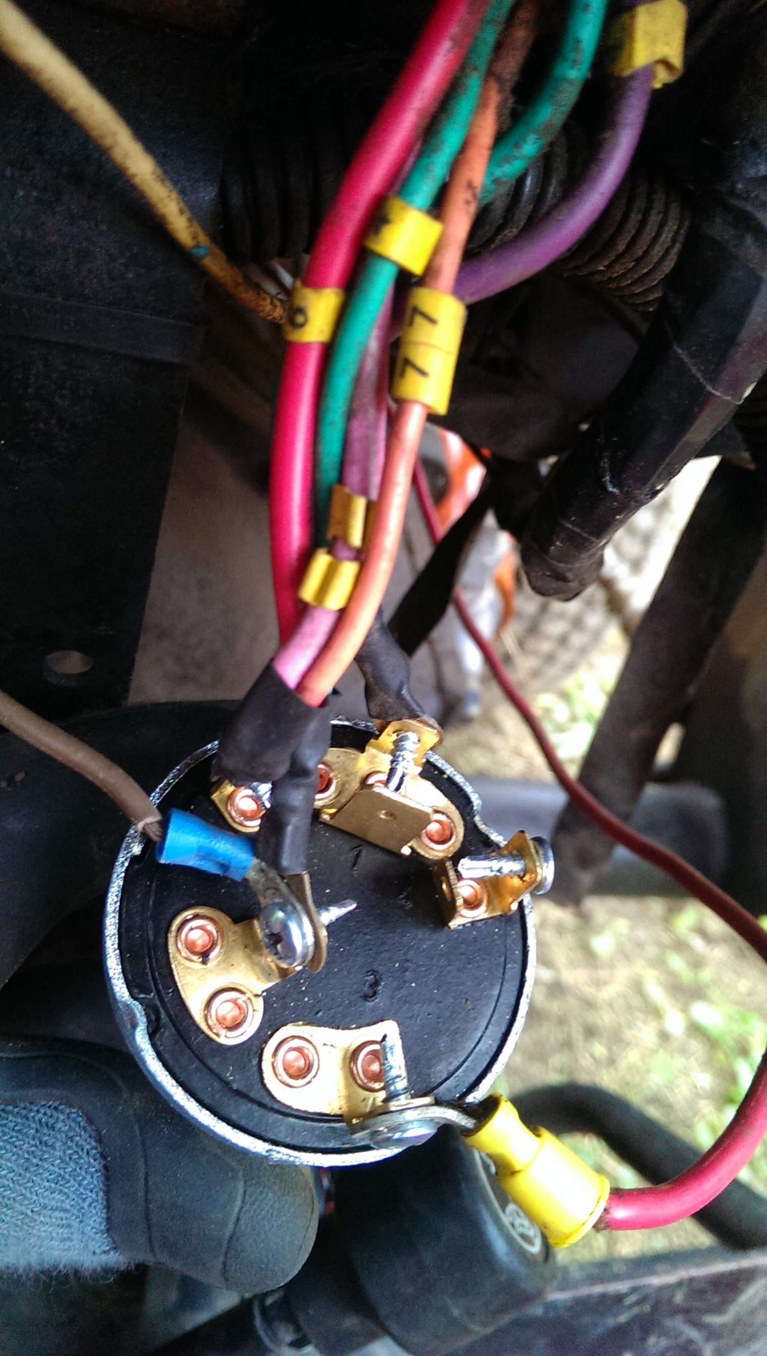

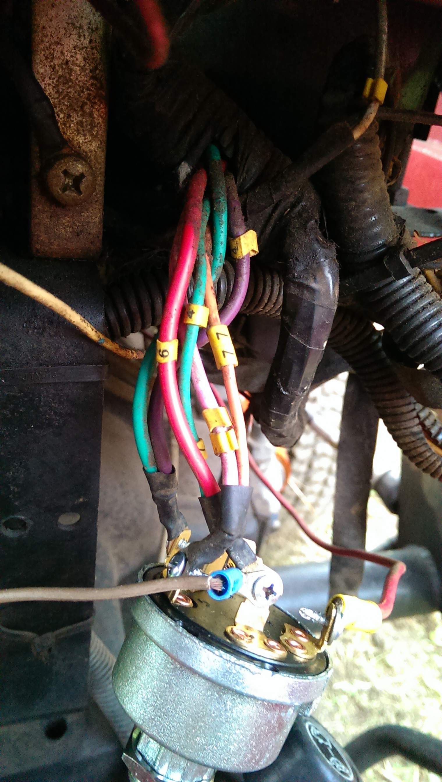

So I tried to take some pictures and hopefully these came out alright, kind of tough angle to get a decent picture. So the wires under the dash area are a bit of a mess and the labels don't seem to make a lot of sense, not sure how this thing got wired. I have wires with duplicate numbers on them (at least 2 wires with #4) wires that seem to be a different color than what is listed in the table above, etc. So I guess first question is, are there supposed to be posts with multiple wires going to it? Post 2 has 3 wires going to it, with 2 of the wires soldered to a single ring connector. Posts 1 and 5 also seems to have 2 wires going to each with the same connector setup.
It looks like for post 1 the #4 (purple) and an unmarked green wire are connected. The purple should be going to the alternator I believe but I have no idea where the green wire is going to.
For post 2, my theory at the moment is that the green wire listed as #4 is actually wire #14 (I am guessing the 1 fell off) which would mean that wires #6 and #14 are connected to post 2. According to the table above those should be going to the horn fuse, the front lamp fuse and the headlight toggle switch. I believe the 3rd brown wire does connect to the headlight toggle switch.
For post 3 there is a thick red unlabeled wire which I am not sure where it goes to, it is definitely heavier than the other wires though.
Post 5 seems to have an orange-ish wire (perhaps faded red?) labelled 7 and a pink wire which is I believe labelled 10. Which in theory go to the clutch safety switch and possibly the regulator fuse?
Does this setup seem similar to what you guys have or do I more wires connected than are supposed to be?

As I asked in post 5 - do you have a multimeter?
You need one to check out those wires and determine where they go.
The first thing that I would do is to use the Ohmmeter and check for continuity between the heavy red wire at the switch and the wire that feeds the Horn Relay fuse. If so, that is the wire that feeds power to multiple fuses in the fusebox. As shown in the information from RonMar and myself, that wire should go on switch terminal #2 (IF the terminals on your new switch operate EXACTLY as the terminals on the original Jinma switch). This would mean that when the new switch is turned right to the first position (on) there is continuity between terminals 1 and 2 on the back of the switch.

Hey again,
I finally found my multimeter and was able to trace some of the wires. So, it turns out the unlabeled single red wire going to post #3 is hooked up directly to the glow plugs and does not go through the separate glow plug fuse. This explains why that fuse was missing from the fuse box, no wires go to it at all! The wires that are attached to the back of the glow plug fuse at the panel go into a junction plug and the other side of the plug has the wires missing completely at that location.
With that being said, is it safe/correct for the glow plugs to be hooked up directly through the main fuse only? Could this be causing there to be too much current going through the fuse and be what is causing it to blow? When I disconnect the red wire from post 3 the starter is able to turn over and the fuse does not blow. So I am assuming this means either the plugs being hooked up directly to the main fuse is the problem or the glow plugs themselves are what is shorting out, does this sound correct?
By checking the resistance I did see that the bracket the glow plugs are attached to seems to be grounded to the frame of the tractor, I assume this is not normal? Overall the electrics on this tractor seem to be kind of butchered and I may someday in the future get a whole new harness and re-wire it up but for now I would just like to get the glow plugs working without blowing the fuse. If it is ok to have the starter and the plugs on the same fuse as it is now, I would probably plan on just getting new glow plugs and leaving the electrical hooked up as is.
I really appreciate your guys help on this, thanks again!
