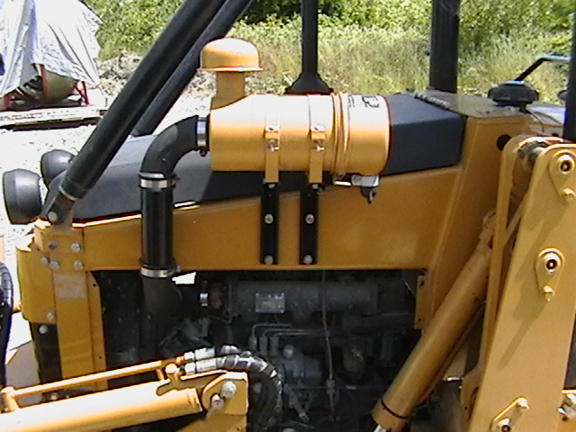

Not a Jinma, but I did away with the absolutely stupid location that Yuchai had and installed a Donaldson assembly.
Are you looking for a complete assembly that uses a safety element too, or do you just want to use a Donaldson element in your existing housing?

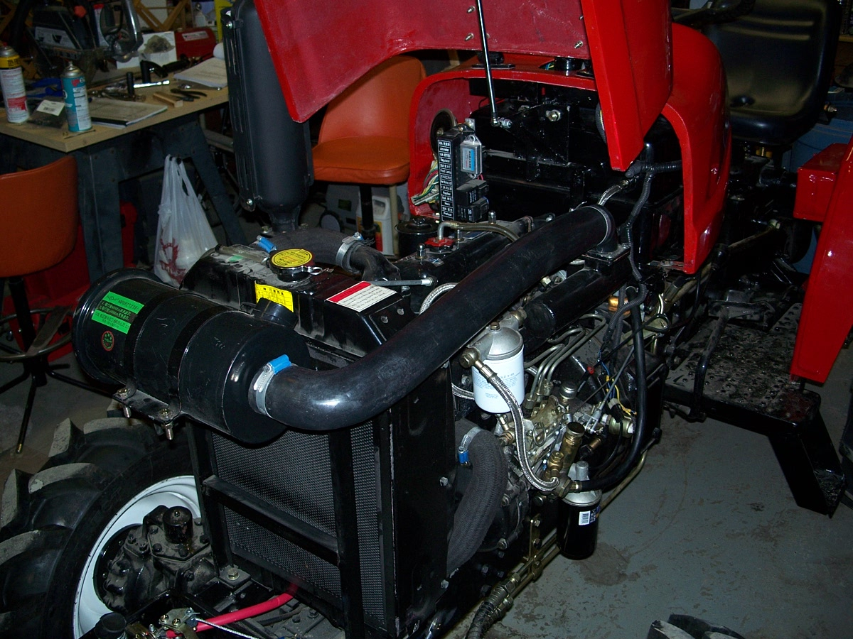

Donaldson P148969 fits my factory 2006 Jinma 284 filter canister perfectly.
Also WIX 42276

For what it is worth: After 15 years and 860 hours I have never had an overheat that was caused by the air cleaner in front of the radiator and the canister has never collected enough dust to come out the squeeze vent at the bottom of the canister. I have only had to replace the filter a couple of times. This summer I was mowing a large area full of weeds and every hour or so I would have to clean the screen in front of the radiator as it plugged up.
The screen protected the radiator just as it should and at the end of the day I figured the air filter must be about plugged too, but to my surprise there was none of the debris like the radiator had in it, only dust on the outside and the inside was perfectly clean.
In my estimation everything was working as it should and apparently the air intake for the canister is in a fairly "clean air" location.
YMMV...
