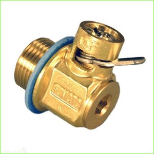

Can you fit a Fumoto?
You still drain down, but easily.
