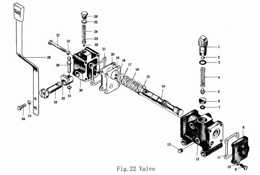

/ Jinma 254 queries.
Thanks Tommy
I appeciate the offer.
As far as I can see, I have the housing with the sliding valve number 14 on the image (the rod with a hole in it)
If the image works, the items I would need are numbers 10 (2 of them), 15, 16, 17, 18, 19, 20, 21, 22, 23, 24, 25, 26, 27, 28, 29, 31, 32, 33 and 34.
If available, I wouldn't mind a measurement of how far below the inlet of the hydraulic reservoir the fluid should be.
Thanks
Ian
/ Jinma 254 queries. #6
That valve is for your 3- point lift ? We cannot get the internal parts to that valve ,we do have complete replacement valves. What happened with your 4 x 4 ? That's what we were talking about
