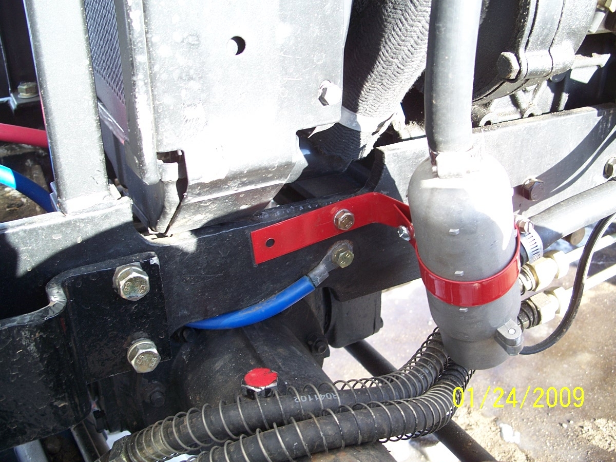

Here is where I mounted the negative battery cable. There was already a threaded hole in the frame and it is easy access for maintenance.
