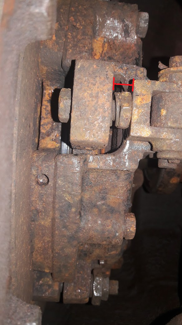

I have made some adjustments to the clutch based on articles and tutorials, obviously it's still not right.
A couple days ago I set the gap between the throwout bearing and fingers to 1/8" and verified all three fingers had the same gap. I did this by adjusting the linkage.
That must mean I need to adjust the clutch fingers themselves. This video (how to adjust the clutch on a tractor, jimna 254 xl sl 2 tractor clutch adjustment - YouTube) suggests I do that by setting the gap to 10mm. Is that accurate?
/ Jinma 254 - General Operational Question
From my reading, if the clutch is slipping, that means I need more pressure on the plate. None of the articles I've found indicate how to do that, they're all how to set the free-play. Is adjusting this gap here how I get more pressure?

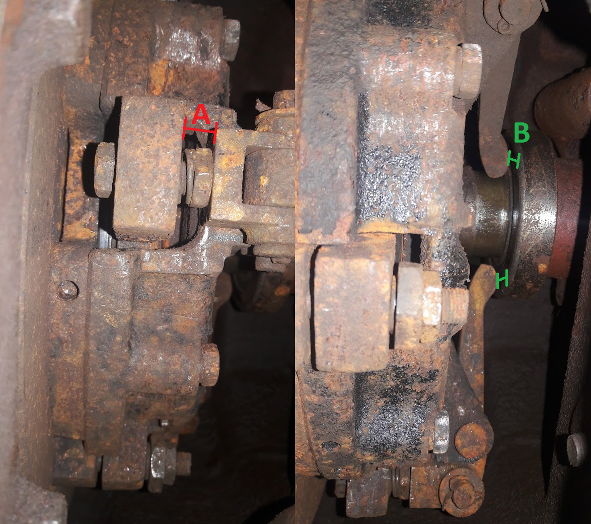

Ok, I think I understand this now, and if someone could let me know if I got this right, that would be great.
  • For the main clutch, there are these two measurements ("A" and "B" in photo) that can be made on all three fingers.
  • They are tied together (adjusting "A" will change "B").
  • The actual measurement of "A" does not matter, only "B" matters (needs to be set to 0.10").
  • "A" is changed by loosening the jam nut and turning the bolt.
  • The narrower "A" is, the more pressure there is.
  • "B" is changed individually on the three fingers the same way, but overall can be set with the clutch linkage.
  • If "B" is set to 0.10" and the clutch is slipping, this means "A" needs to be reduced (more pressure).
  • All "A" should be adjusted X amount of turns to increase the overall pressure.
  • Once all "A" have been adjusted, the clutch linkage should be adjust so that the smallest of the "B" gaps is 0.10"
  • With one "B" gap set to 0.10", small adjustments should be made to the other two fingers so they are also 0.10"
  • This means that "A" will not be the same on all three fingers, but this is ok, the don't have to be.
Is my understanding correct on all of this?

Be careful with clutch adjustments - it's really easy to get it adjusted slightly off center and have the clutch plate wear unevenly. Mine was adjusted wrong from the factory and it ended up needing an entirely​ new clutch.

As long as the distance between the throwout bearing and fingers are all the same I'm good, right?
Yes, I think so... but hopefully someone with more experience can chime in here.
I tried to do the adjustments to my old clutch exactly like you are describing, and I was very careful to turn each bolt exactly the same amount. My clutch worked fine for the transmission, but I couldn't get the PTO to engage. I finally gave up -- I couldn't get the PTO and transmission to both work at the same time (with my old clutch). So I just set it for the transmission to work, and asked the dealer to look at it the next time it was in the shop. Looking back, I think my clutch plate was worn unevenly, and I probably had no chance of getting it adjusted correctly.
After replacing it with a brand new clutch, the dealer told me that the range of adjustment was approx one-eighth of a turn from working to not working (for the PTO). He had the tractor on a dyno while he was doing the adjustments, so he was absolutely sure that the transmission was losing power when he got out of that adjustment range.
I don't know if that is normal or not, but that was my experience with it -- YMMV.
