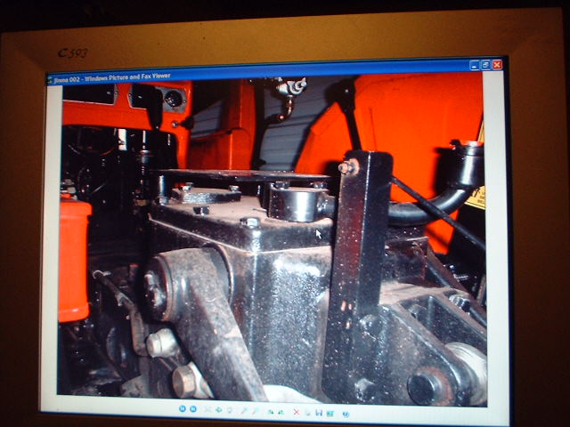

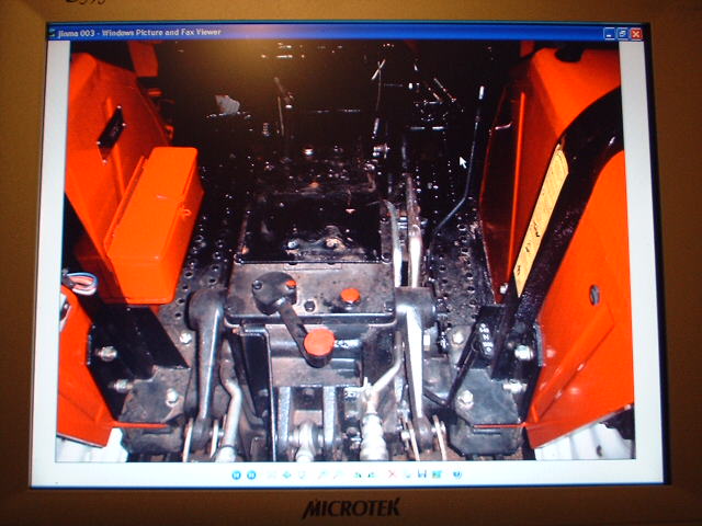

here is another pic. The red cap on the left is the fill port, but it fills verry slowly there, I got a lot more in faster by removing the red bolt on the right. That one had a dipstick and I needed more than 2 gallons of fluid. GLad I checked as the FEL was woking erratically, and someone here advised me to check the fluid. They were right on too. Nice and clear but way low, had to be a dealer misteak cause theres no leaks. FEL works fine now.
Another thing about this filter location. Now its at the bottom of the reservoir...so while priming now would happen automatically, I would have to empty the hydro box completely before I checked out the filter (right??) /forums/images/graemlins/confused.gif if thats really where its at....(whats behind the mystery flange with the 4 bolts? curiosity is killing me.....
Do you think the filter would be less likely or more likely to get clogged in this location? If crap settles to the bottom I would think it would need more attention, not less. And I wonder what that filter looks like. I havent really looked for an inline filter, but if I do find one, would that take the place of the under-the-seat filter shown in the 100 hour service pages? Am I looking for TWO hydro filters??? gotta look tomorrow.

Completely different setup. Any pictures from the front of the unit? Is the Valve still under the front edge of the seat?

More Pictures of the entire rear end and side views of the engine and in front of the seat too Please.
This is beginning to look like much upgraded unit.
Is that 2 oil lines at the back now for quick connect?
